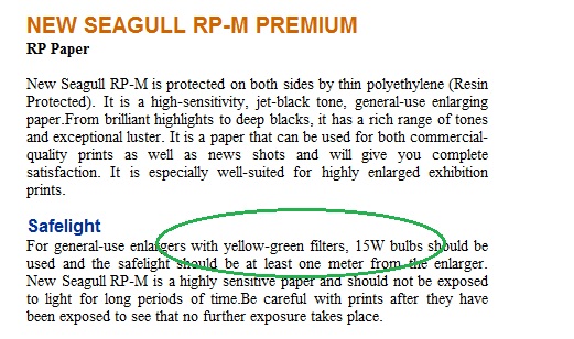

F4user
Jun 2, 2014
80
@pen
You have not answer to the question >> Have you read datasheet from my link ?
Anyway, for your convenience i made for you a screenshoot.
Do not trust "copy-paste" skills of a B&H bored employee
In the specs it clear say green-yellow safelight so your assumption was totally wrong.
My initial guess for orange colour was more close to Oriental specs.
The paper seems to be sensitive to red spectrum even is not clear stated.
On any manufacturer specs they say : "reserve to change without notice" and that is based on our money.
If you prefer LED light you must change the colour - orange or yellow ( yellow , must be tested ) or ( orange should work ).
Check LED manufacturers specs for wavelength. I think 600 nm should be fine for all Oriental papers. Look at 600 nm colour
