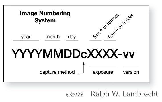

Here is what I do:
In addition to have a consistent numbering system for our negatives, it is equally important to maintain clear image and printing records. A 15-digit image numbering system keeps negatives and digital image files organized. I have used it to catalog my moderate library, which contains thousands of images and spans several decades. It has served me well, and there is never an issue in locating the negative or digital file for a particular print, as long as the print is labeled with the corresponding image number.
The image number starts with 8 digits to identify the year, month and day, on which the image was taken. This is followed by a single letter for the method of image capture: ‘a’ for analog and ‘d’ for digital files. For analog files, the next 4 digits are used to identify the roll of film shot that day, and the specific negative frame on that roll. If I shot sheet film, the first 2 digits are used to point out the format (‘45’ for 4x5 sheet film) and the other two identify the film holder. For digital files, all 4 digits simply reflect the exposure counter of the digital camera, and I add 2 digits to distinguish different versions of image manipulation.
