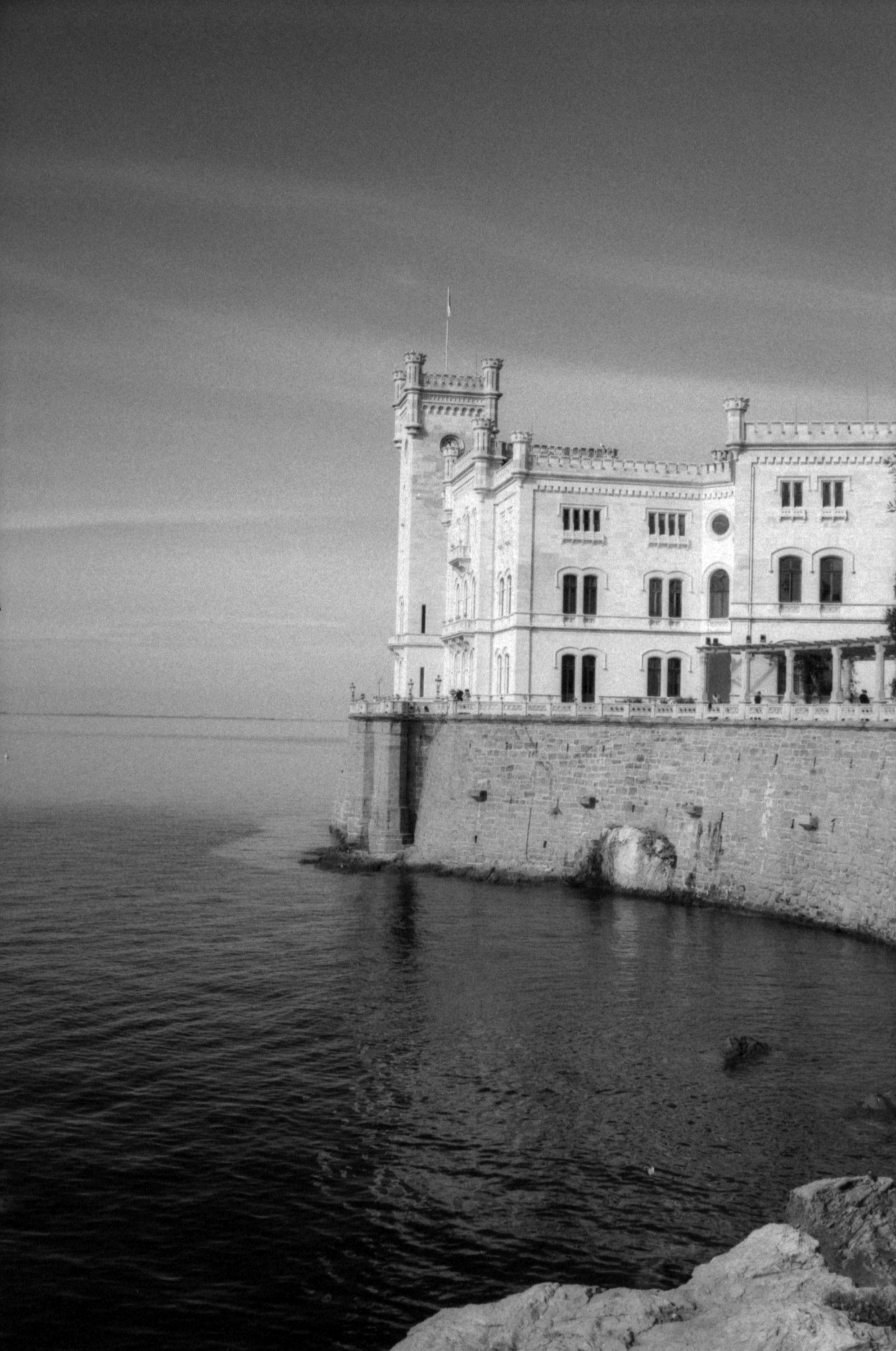

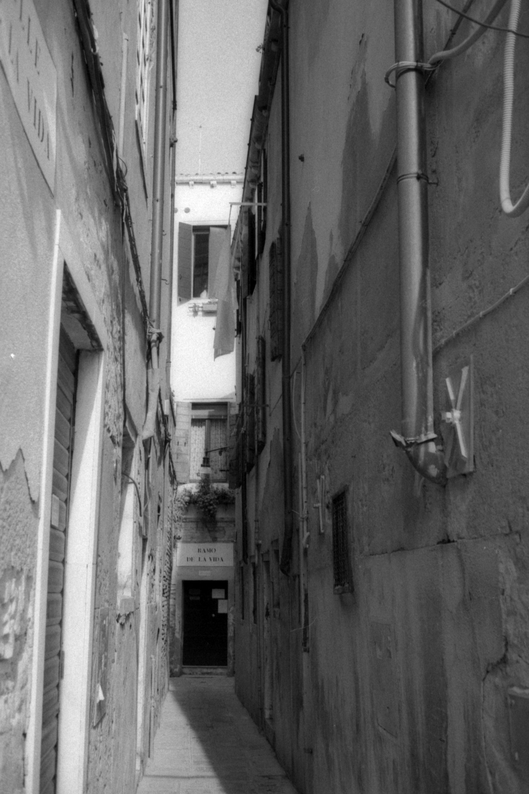

as promised I am attaching two photos developed from the test roll.
rollei 35 tessar with orange filter, ilford hp5 pushed to iso 1600 and developed with rodinal. scanned with vuescan and epson v500. no lightroom or post production.
