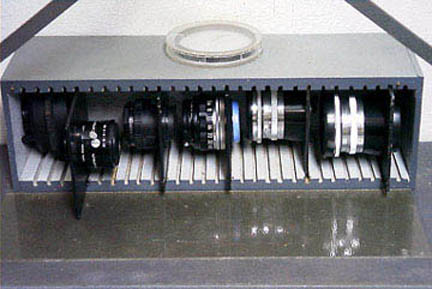

It's not too hard to nail together a box with slots cut in it with a table saw to slip lens boards into. I imagine you can hang this on the wall pretty easy too for good access. Thats such a good idea I'm going to try this out. Thanks!

i had something made like the lens "garage" years ago. no door on mine but the concept is the same. small world :smile:
So there is not a company who makes this kind of thing? This seems like a no brainer, darn...

Thanks for the suggestion about horizontal -vs- vertical wall hanging.
I'm doing some layouts right now.
I'm thinking of slots at 1/2" centers.
To the next 1/2", how much space would each lens need?
Some lenses project behind the lensboard, (rear caps included).
Each of my medium format lenses occupy 2-1/2" wide bays.
My 4x5 lenses occupy 3" bays each.
The Lens Garage in the photo (post #3) is 15" inside.
I'm back to the drawing board...
Reinhold
In my experience, no lenses need protection from fungus more than enlarger lenses, since they are usually in a dark place and there are liquids around. So some provision for humidity reduction might well be incorporated, which could be as simple as a bag or two of silica gel.

I figure better to have a little more room than not enough. I can't see any of my lenses being longer than 3".

If you build a Greg Davis type, beechwood would be nice. The critical thing being leave unfinished. Most all finishes give off fumes.
I would use some king of loose cover like a curtain. Allow for air circulation, but keep off dust.
Anyone do something in a sealable plastic box?
I'm thinking sealable so I can put a desicant in the box and not worry about moisture getting into the box.
