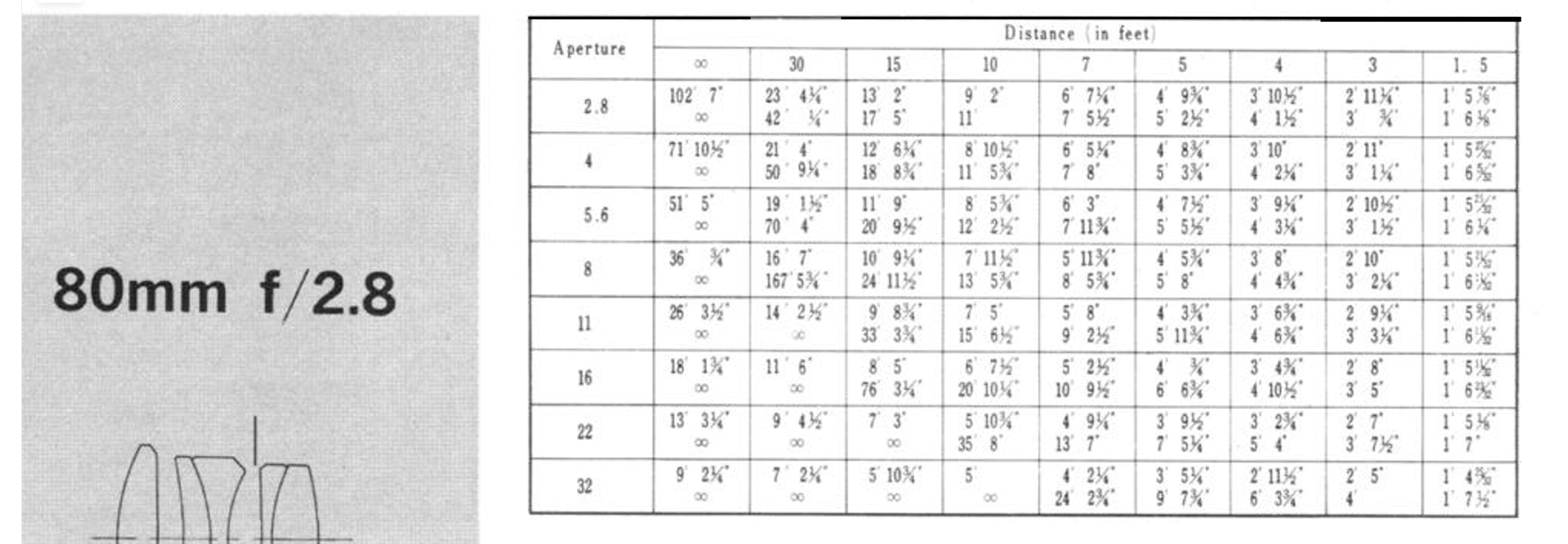

OK, I think I know what it is. I understand that you want to shoot wide open—or with a depth of field as shallow as possible, which, in the case of the Mamiya, isn't quite the same thing.
I believe you're forgetting to factor a couple of things. First, bellows extension. You have to remember that the closer you are to your subject, the more your bellows will extend. With the 80mm, that means you can lose up to two stops.
Next, you have to check your depth of field chart. Again, the closer you are, the shallower your depth of field. As you can see here, f/5.6, at 3 feet, the depth of field is barely 3 inches. Which is less depth of field than if you're using f/2.8 at 7 feet, which is 10 inches.
So, again, what you seem to want is not shooting at the widest aperture, but (if I'm to judge from the photo example you linked) to shoot at a narrow depth of field.
This means you have a little preparation to do, and a bit of calculus. How you want to frame your picture will give you your distance. After that, you chose your aperture according to the depth of field effect you want. Once you've metered you scene, you figure out what shutter speed will work with the aperture you've chosen—you might want to have a tripod with you just in case—, all the while not forgetting to adjust your exposure according to bellows extension (chart for that is on the left side of the camera).
Not sure this is clear, but the photo you linked to looks simple but requires a really good understanding of how these cameras work.
Not sure this is clear, but the photo you liked to looks simple but requires a really good understanding of how these cameras work.
THANK YOU VERY MUCH. I printed this chart when I first got the camera. I'm still very slow with all the mental prep work that goes into shooting with the C330. I've achieved some fantastic results shooting at narrow depth of field on lower film speeds, and I'm hoping 3200 will allow for more flexibility for this type of work. Thanks again and best wishes!
