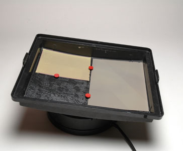

Dear Soeren and Brendan,
What you need is a Paterson Orbital tank, which is a sort of covered, light-trapped 8x10 tray with 'golf tee' dividers to cut it down to 5x7 (two up, two dividers) or 4x5 (four up, four dividers). They are (I think) out of production, but sufficiently recently that you should be able to find 'new, old stock' in some shops. Otherwise it's either camera shows or (makes sign of cross) Fleabay.
Ideally, roughen the base either by 'kissing' it with a Dremel engraver (my way) or dabs of glue. This stops the film sticking to it and means you don't have to clear it afterwards (see also BTZS tubes). With 4x5 and even 5x7/13x18/half plate the film should skate about but with 8x10 there is a risk of uneven development if you use the motor base. With manual agitation it shouldn't be a problem.
I'll try to post a couple of pics on this thread, maybe tomorrow (it's scanning and getting around to it) but I'll also try to do a free 'how do I..? thread in the photo school at www.rogerandfrances.com. It'll take a day or two to write it; a week to mail the CD to Karl (the webmaster) in California; and a week or more for him to put the module up. But there's more and more on that site...

Pics of Paterson Orbital attached (I hope). Today I've done a module on Orbitals for the 'How Do I...? thread in the Photo School at www.rogerandfrances.com and I hope Karl can have it on the web in a month or so.
The open one has one sheet of 5x7 and one of 4x5 in it; there is room for another sheet of 4x5, obviously.

Soeren

Dear Roger
Ahh thats the Paterson Orbital. Now things come together :smile:
It Dosn't look that big. What is it standing on ? is it part of it ?

Dear Soeren,
Yes, it's standing on a part of it. There's a sort of domed base that makes the agitation possible -- a manual version (twirl it by hand) or a power version (shown). You CAN use it without but it's harder and longer dev times are advisable.
