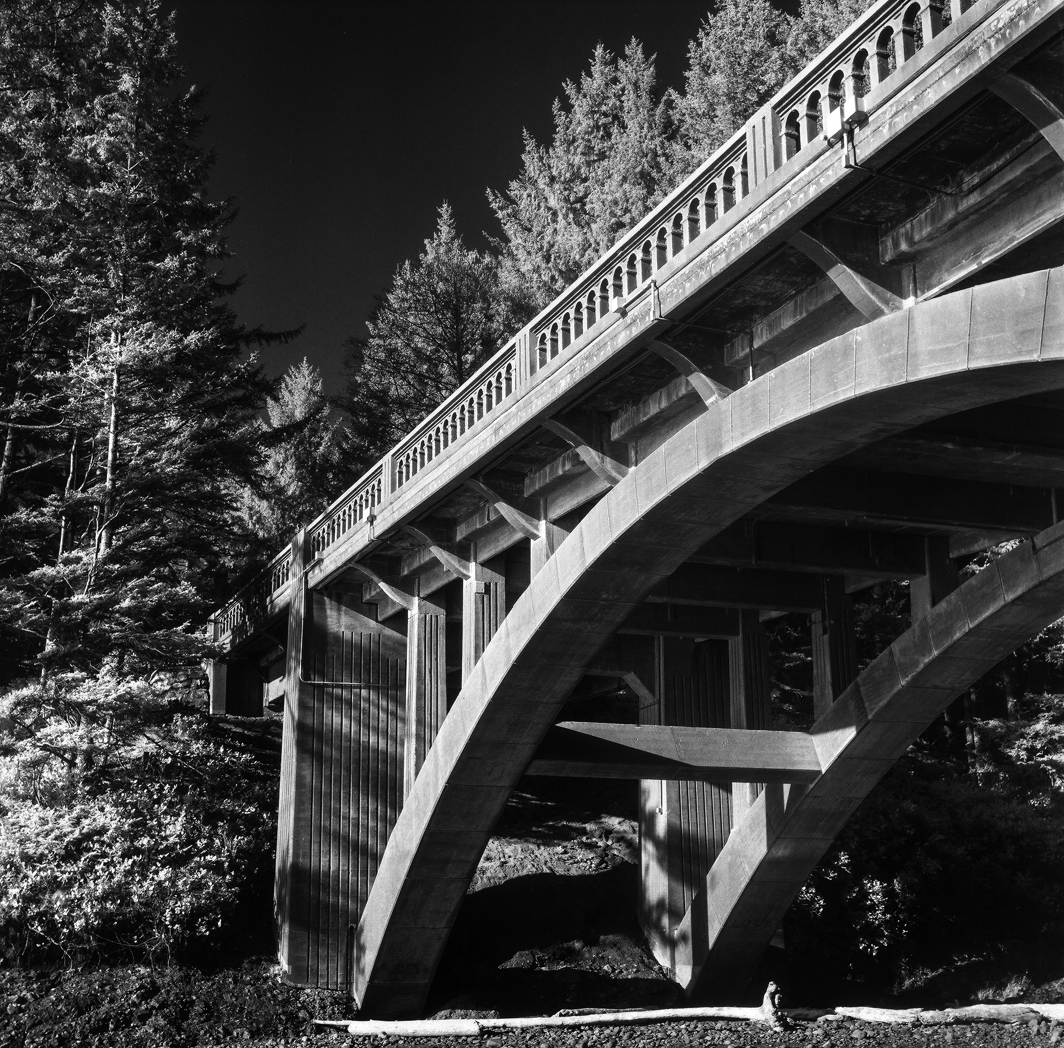

bluechromis
Sep 11, 2015
638
I agree that that Rollei IR 400 unfiltered is not IS0 400 especially since Maco also sells Rollei Superpan 200 which appears to be the same emulsion both derived from Agfa Aviphot 200 aerial film. I think I remember Henning Serger say that his testing showed it had a maximum usable (unpushed) EI of 160. I usually shoot it at EI 125 unfiltered. Maco is a quirky company and is hard to explain why they call it 400 speed. It may that it was originally Aviphot 400 but when that was discontinued they switched to Aviphot 200 but didn't want to change the same. For IR images I use the filter factor method and meter unfiltered and then go down 4 - 6 stops with a Hoya R72 filter and usually shoot it at EI 12 - 6. But until one really gets a feel for IR exposure it is best to do a good bit of bracketing of exposure with IR shots. I would echo what Matt said about IR exposure, it is not just the apparent amount of light but a lot of other things like angle of the light, time of day. Also the subject matters a lot. Some subjects look little different in IR and others are dramatically different. My trifecta is scenes that combine water, vegetation and a nice cloud filled sky. I think IR400 has perhaps the greatest IR sensitivity of remaining films. But to get a real IR look with Wood Effect etc. my experience is that an R25 filter won't cut it. I have not used an R29. I have only gotten IR with a very dark R72 type filter. I recommended the swinging filter adapter for SLR's. Because of the dark filter and the need to stop down considerably because of difficulty of focusing with IR, using the IR shots are for me on a tripod with longish exposure. Because of this one has to be wary of nearby foliage etc. that might be moving in a breeze and create motion blur.
