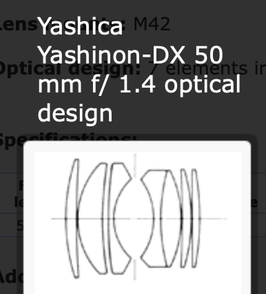

Decided to remove fungus for Yashinon-DX 1.4 (Serial 541191xx)
After putting it back together, the infinity focus is wrong (seems like center is in focus, but the outside circle is just a blur).
Therefore, I am thinking I put one of the lens elements in an opposite way (although it seems impossible to be wrong as the surfaces do not fit otherwise).
Wanted to ask if anybody knows the optical formula / chart for the lens elements for this lens, so that I can check and redo my assembly if necessary.

Spacing between groups being significantly wrong could do that too...

Nice lens. Not easy to find. Take care of it. I believe the two rear-most elements are similar but could be accidentally interchanged.

@ic-racer, @Donald Qualls thank you! I had a spacing ring before the 2nd to last element, it should have been before the last element.
Now getting infinity focus.
