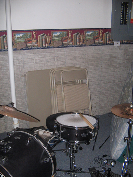

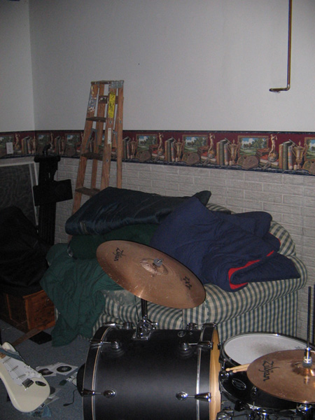

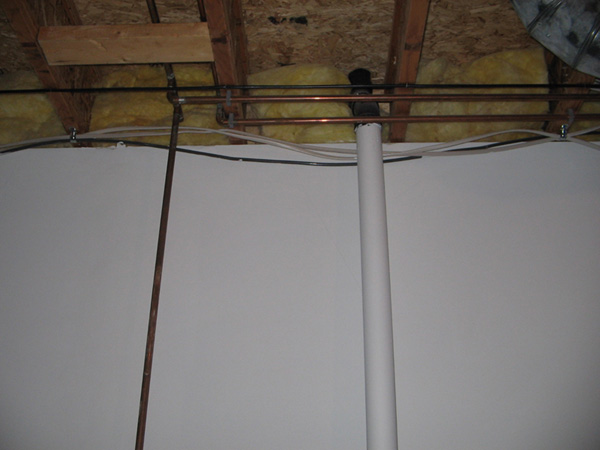

Hello everyone, first post here and I'm in a bit of a dilemma. I have two choices to build my darkroom, one is a much larger room with no windows, and has open piping for water, BUT I do not know how difficult it would be to run water into the room from a pipe, tap it? It ALSO has a Sump pump (because it is in the basement) would that be a use as a drain for chemicals/liquids or would it not be safe to drain it outside.

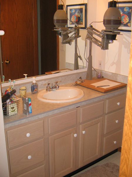

The second choice is a two part bathroom, I would have to have my wet area be on top of a bathtub. The upside would be I would have access to water pretty easily. If I go this route, would the chemicals, stain the porcelain of the bathtub? If so, would a protective sheet of some sort do the job? I am including pictures of the two rooms, Thanks for your time!

I’d go with the larger room in the basement, which could probably be made into a permanent darkroom. Remember, you can never have too large a darkroom! Tapping into an existing water supply is easy. If the sump pump discharges into a septic tank or sewer, use it. Otherwise, you would need to add a holding tank/sump pump to discharge into the house sewer system. Or, use the existing sump pump for just water (print washing, etc), and a separate, smaller holding tank for chems, to be disposed through the existing house sewer system.
I vote for the basement. More room, less intrusion on the rest of the family, and the ability to have permanent facilities.
Your supply pipes appear to be copper. They are relatively easy to tap - all it takes is a pipe cutter, torch, a few fittings and some solder. If you aren't ready to try it yourself, I suspect that you have a friend or neighbor who could do it for you.
I presume that your plan is to do traditional silver printing. You didn't indicate where the sump pump drains - does it go to an actual sewer, or does it simply run outside the house to a ditch or swale? Regardless, I suspect that using it as a darkroom drain is not a major problem - your volume is not likely to be excessive, and since the sump will receive mostly wash water and only a fairly small amount of chemical, it's not likely to do any environmental harm.
Darkroom chemicals generally won't cause permanent stains on porcelain. Developers are probably the most agressive stainers - and they can be cleaned up with a little hypochlorite bleach (ie, Chlorox). If your plumbing fixtures are acryllic or fiberglass you might want to be a little more careful to rinse everything down after use.
The sump pump drains straight to the outside of the house. The only concern about the larger room is the effort needed to tap into the water pipes, My father and I have no knowledge in the area of plumbing unfortunately. I was planning on using the sump pump as a drain for the washing process, so I don't have many worries about environmental damages.
That downstairs room is a good bet. Go to Home Depot or Lowes or some other home supply store and get a book on plumbing. It will cover the basics on soldering copper pipe. You will do best to get some pipe and elbows and a torch with the necessary solder and pastes and play with it for a while before trying to cut into your house pipes. You'll find the technique is pretty simple and straightforward. You may even end up with a nice looking "pipe sculpture" to show off to your friends.

There are devices on the market which clamp around a copper pipe and you tightne a screw which wil puncutre and seal around the copper pipe. YOu may have to go to a good plumbing supplier to find them as I have not seen them in Home Depot.
