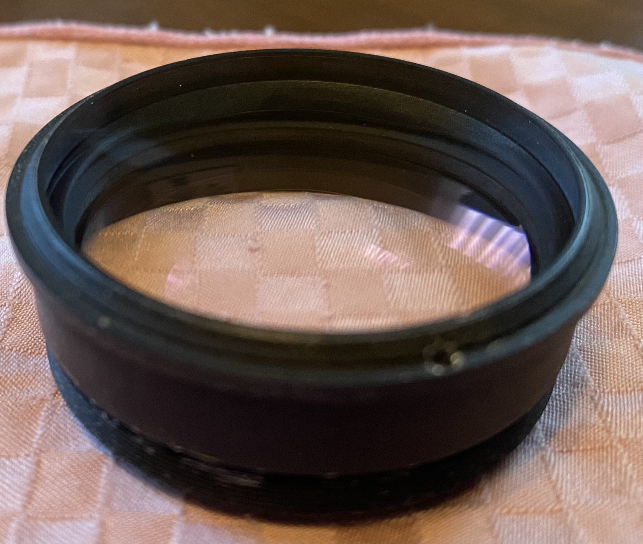

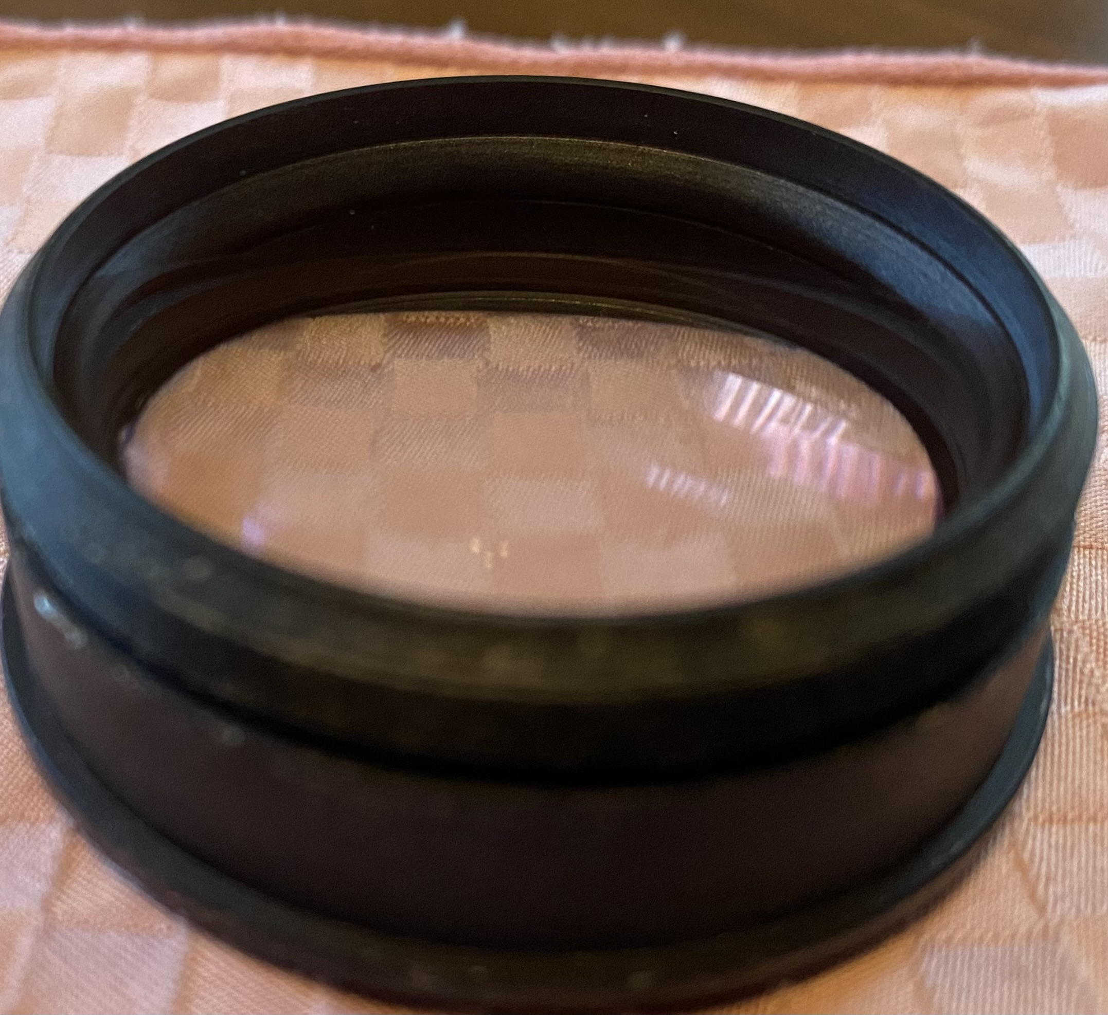

I was wondering if anyone had any ideas about how to open the middle lens group of this lens to clean out some fungus. I’ve tried soaking the threads with acetone and lighter fluid. I’ve also tried heating it up with a hair drier. It doesn’t want to budge. Any ideas?
Many thanks!

Usually I try it the same way - acetone and hot air - and then it is the question whether the ring which holds the single lens has notches for the tool (then use the tool) or not (then use the rubber prop) to remove the single lens.
Some times both won't work, so you have to use a hammer and a small chisel to drive the ring off.

Thanks to everyone for their suggestions! This group is quite stubborn to get apart. I’ll keep trying.

I am surprised that this lens group has fungus.
Are you sure that there is fungus, and not a clouding in the cement which holds the two glued lenses together?

Yes, I can see quite a bit of fungus spidering inside. Unfortunately, there was fungus on almost every lens element in this lens.
