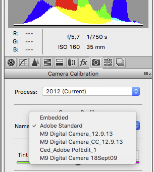

Have you tried all of the Camera sets/dates offered when opening the files in PS?
Camera Calibration.png Make a custom setting that suits your taste?
View attachment 283714 Make a custom setting that suits your taste?
Thank you. I had never explored these settings. My D90 opened fine on the default Adobe setting. I tried "Camera Standard" for my D850 and it made a huge difference in one step, replacing a whole series of levels and contrast steps that never seemed quite satisfactory.

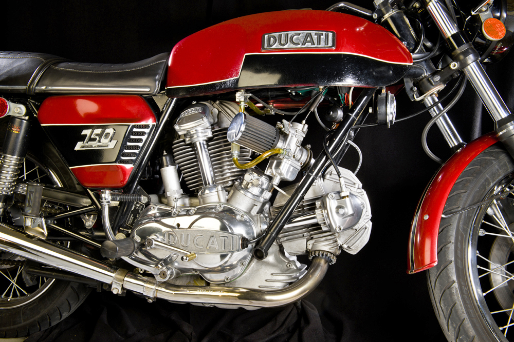

Here's an example:

So was that a big improvement anyhow?
The result of the bike looks near perfect on my screen.
Yes, the previous starting point upon opening was very dark. After a lot of level changes and shadow lightening it got better but the overall contrast was lacking in punch, even after running it through Lightroom for more work. The image above took about two steps and has much better contrast in the highlights. This is much more like I saw on the camera's LCD.
