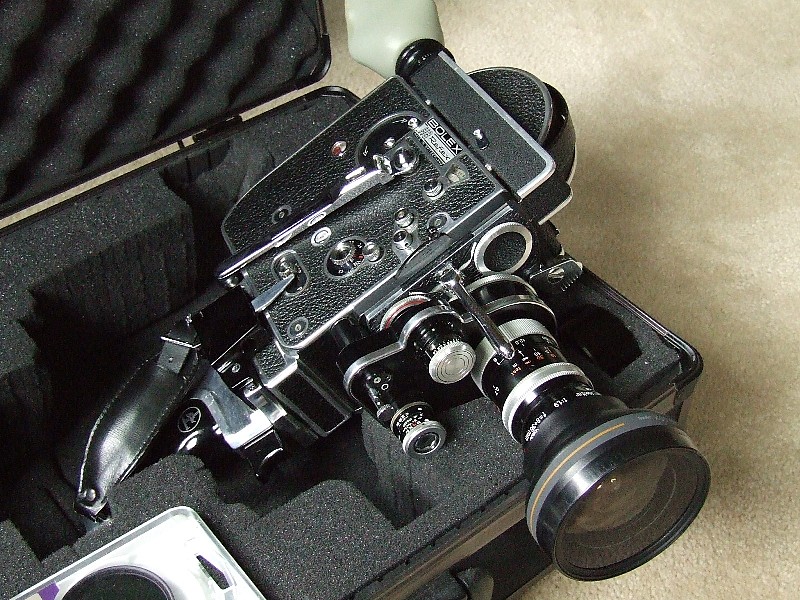

The Bolex 35EE zoom lens coupled with the SLR Bolex REX (uses a prism for SLR function) had a cable (not attached in the picture) that connected the pistol to the meter. When the trigger was pressed, the cable activated the meter. This meant, one could focus with the lens wide open before the shot. The camera then automatically stopped down and metered when you pulled the trigger to shoot.
So the lens would still be wide open for a moment as exposures began, making the first few frames over exposed...a 'look' duplicated by some of the best 'fake move film' digital effects...

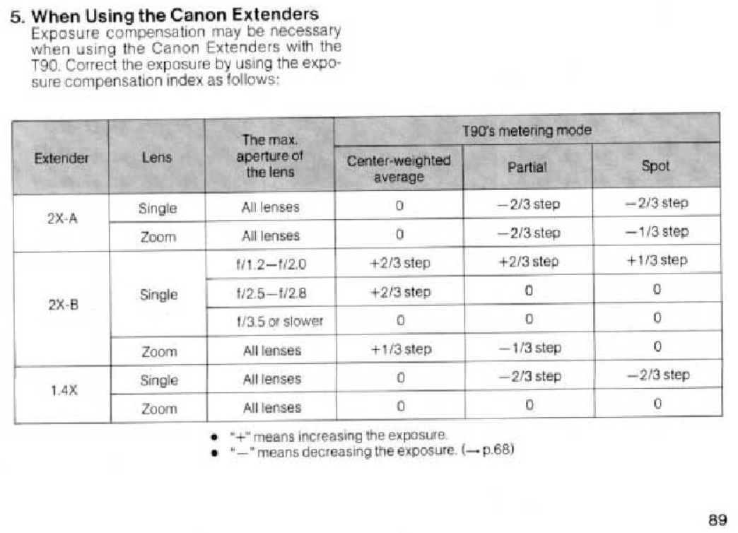

I'll just note that many cameras that provide full aperture metering do so with a catch. Some will let you know in their manual (example: Canon T90) but others will leave you to figure it out on your own.
Certain lenses will fool their metering system when not stopped down and require you to dial in exposure compensation. Certain teleconverters will do this as well. Sometimes the amount of compensation you have to dial in depends on the metering mode. It seems if you use lenses that extend more toward the mirror, have very fast apertures, are older, only partially compatible, or are third party, you increase your chances of this.
