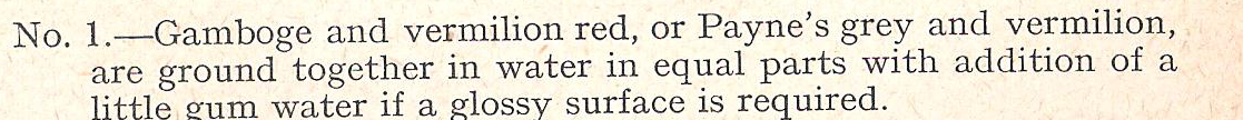

From the BJP Almanac 1924.

re: recipe from the BJP. Vermillion pigment is made from cinnabar a mercury ore, today it's synthetic mercuric sulfide and mostly made in China (no surprise there), wiki says it's very toxic so no licking the brush! Gamboge is a red/brown/yellow pigment made from an evergreen resin, Payne's gray a mixture of iron blue (Prussian blue), yellow ochre and crimson lake.
I prefer the msds for the Kodak stuff!
