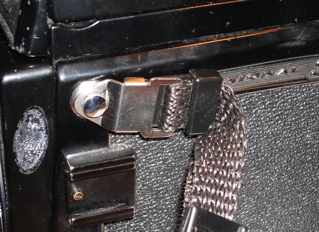

Hey guys, I just bought an Op/Tech Super Pro Strap "A" for my 500C/M. How the heck do I get the little black clip thing to clip in? The thing seems impossible to do, especially since the little chrome clips don't move away from the camera and the black clip is in between them and the camera. Is there some trick to this or is it just incredibly difficult?

Let me see if I can describe this in words only....
You need to pull the black plastic clip up away from the metal clip. It will slide up the strap. After that the metal clip -should- slip over the lug on the camera body. The clip is made up of two pieces of metal both of which the strap passes through. The outer piece of metal will slide back away from the camera lug hole. On my strap the metal clips cover, the flat part that is on the outward facing side, was just a little too long. It interfered with the camera body lug and wouldn't allow the strap clip to go on. I had to use a decent amount of pressure to get that outer part to snap behind the body lug. I used a small screwdriver to push on it, just behind the lug. A better way might be to get a small file and file a small relief to allow it all to go together easily. So, once the clip snaps in place you pull that plastic part back down the strap. It will fit into the metal clip, right behind the lug and will act as a lock to keep the whole thing securely locked down.
Pictures do speak a bunch of words so here's a couple quick ones of one of the mounted lugs....

Thanks guys. I finally got them on, but wow, it was incredibly difficult. Probably never going to take it off. Is there much (or any) of a problem with the clips scratching or wearing down the body of the camera?

Q.G., The main problem I think is clearance. First the sliding plastic clip that is supposed to lock it all together fits behind the strap, next to the body. Due to the camera lug being square the clip doesn't rotate so you have to work right next to the body. Its all just very tight and fiddly. Looking at the picture you posted of the original strap I see there is no locking device, thats whats been added that makes it all tougher. You can clearly see this part on the new strap in the pictures I posted.

I see. It's the black thingy behind the clip that is causing problems.
The original straps do not have such a thing. The clip sits very securely over the lug, without any fear that it might accidentially come off. The spring plate, fitting behind the lug, does not need an additional locking device to keep it in place.
I don't really understand why the Op/Tech clips would need a locking thing. Perhaps it would be best to find an old Hasselblad strap, snip off the clips, and fit those on an Op/Tech strap?

I had the same feeling about the Optec strap when I was putting it on. Especially as the spring plate is a bit too long and has to be forced past the lug, I don't think it would be prone to accidentally coming off. If the strap was going to have to be removed often I think I'd just cut off the plastic locking piece.

I use the Op-Tech system for several of my cameras--the neck strap combined with different lanyards. For the longest time, I was trying to insert the plastic retaining clip into the body of the mount (type B) until I discovered this simple trick:
THE LANYARD BODY WILL SNAP ONTO THE POST WITH THE RETAINING CLIP IN PLACE!
Of course to remove the clip and lanyard, it is necessary to pull the plastic clip out and lever the snap plate up. I tried this with an "A" mount also, and it was the same deal. Sometimes, I think we make things harder than what they need to be...

The instructions missed a point. first the retaining slide has to be slid back. then you can clip on the lug. but trying to get the retaining slide to connect to the rest of the gear is a pain. the slide is blocked by the strap. sending it off at an angle! thought I had it in but the clip disconnected from the lug. good thing the camera wasn't hanging around my neck!!

Not to bump an old thread, but a little info that might be useful to someone struggling with this. I happened upon this while trying to attach the op/tech straps. I found that if you remove the film back from the body, the plastic clip is quite easy to slide back into place, due to the better angle and more space to move your hands around.
Didn't see anyone mention it, so I thought it was worth adding here for archival purposes.
