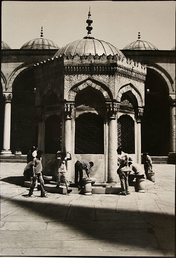

Here is one example that I have shoot with Hi-Matic-F:
