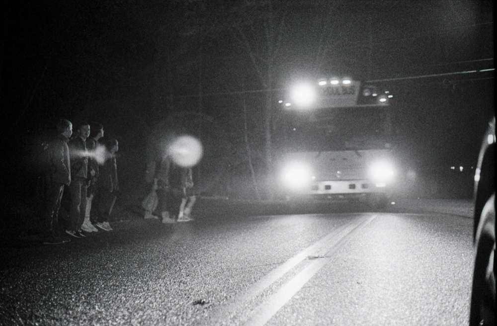

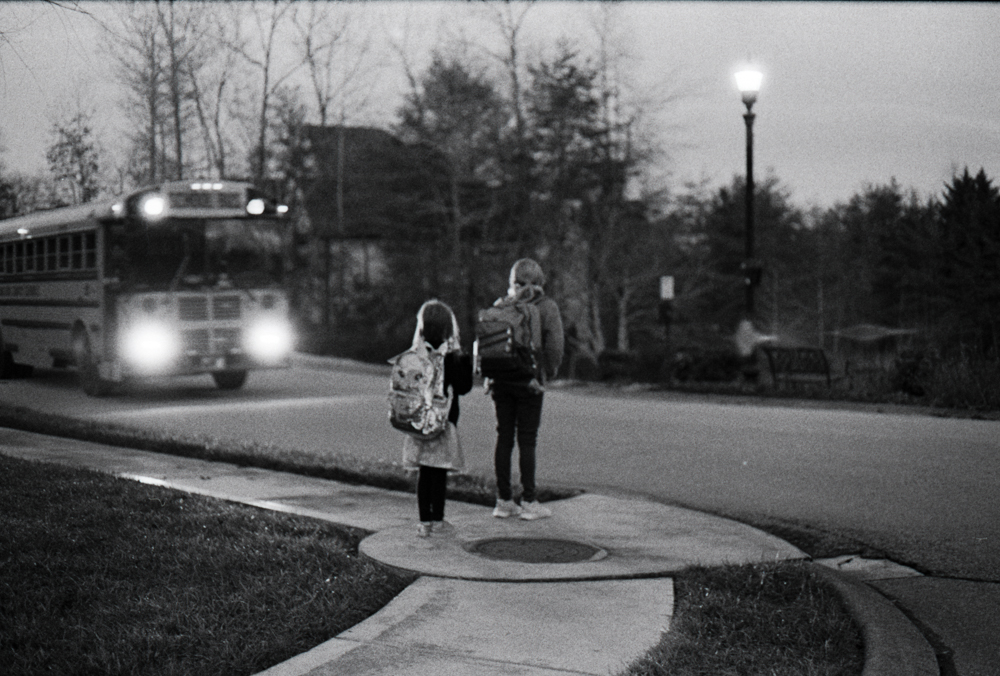

Let me figure out how to post some p3200. I shot a roll in January and really liked it.

It looks best at EI 800, anyway... Post 'em when you're done! Would like to see them. I haven't shot the new stuff... only the old stuff, and that was several years ago, in Xtol.
Here are two shots from the bus stop.

These look fine. The second one especially in the dark. As Andrew says 800 is fine. I only ever had a problem once with different films in the same tank. After 25 pages of posts from members trying to help. I discovered it was my own fault. The films were in fact teenage brother and sister and being in the same confined space for 10 mins created a real problem :D
Avoid this and you are good to go.
