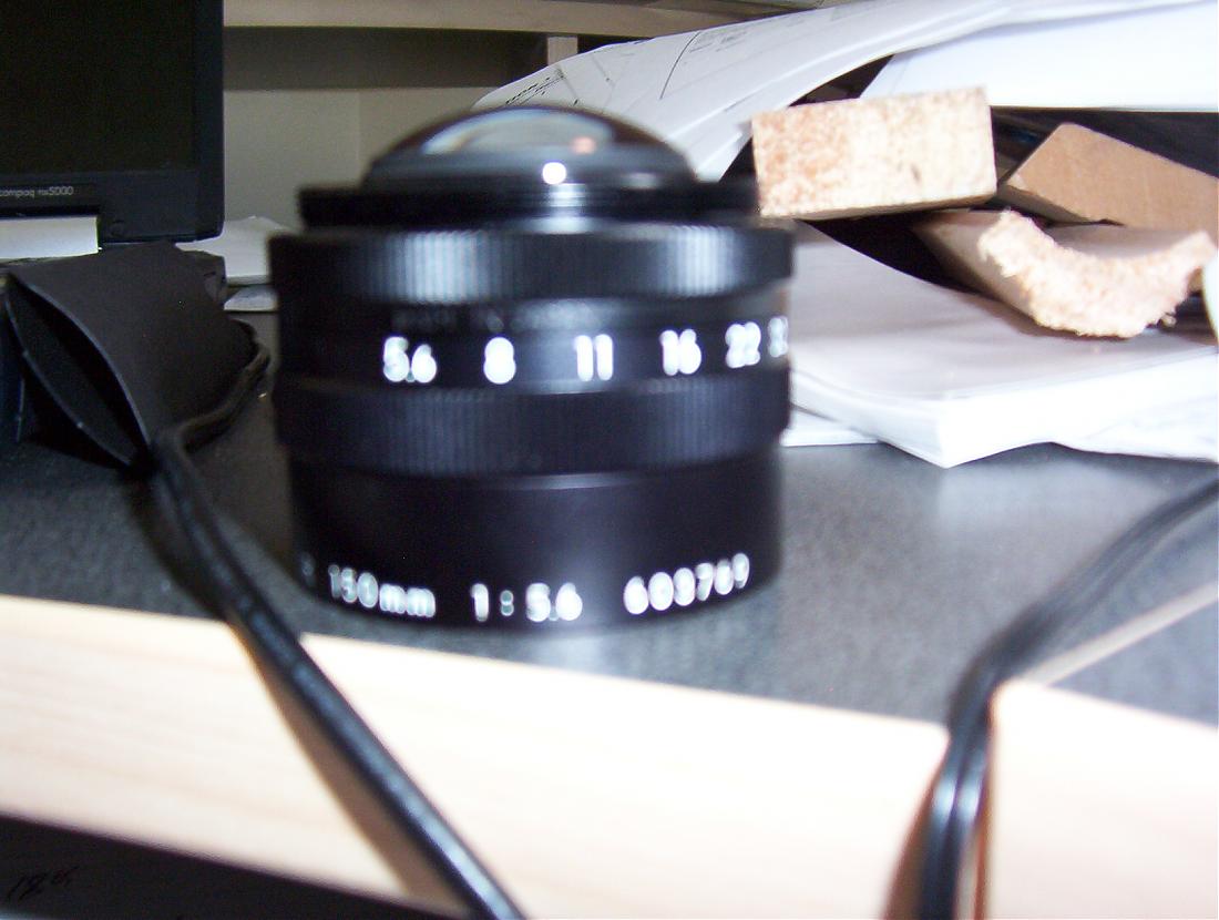

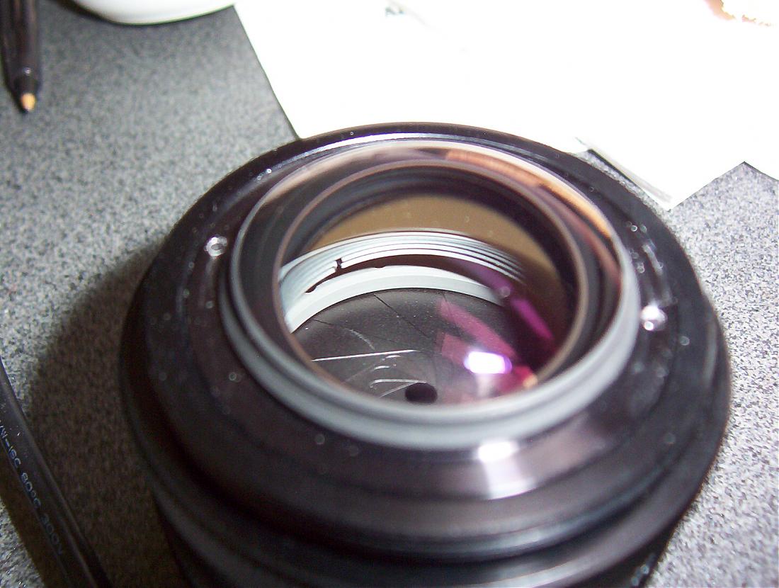

Here are a couple of pics showing the problem. Sorry the second one is blurry.

Well, it was actually the rear of the lens stuck in the lens stage of the enlarger. Looking at Mick's 150mm lens and LPL enlarger was a big help. I got home, took the lens stage off and managed to coax the lens thread out.
