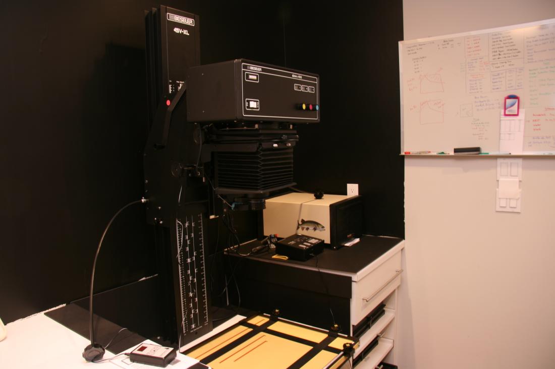

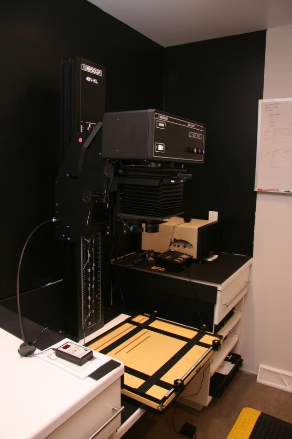

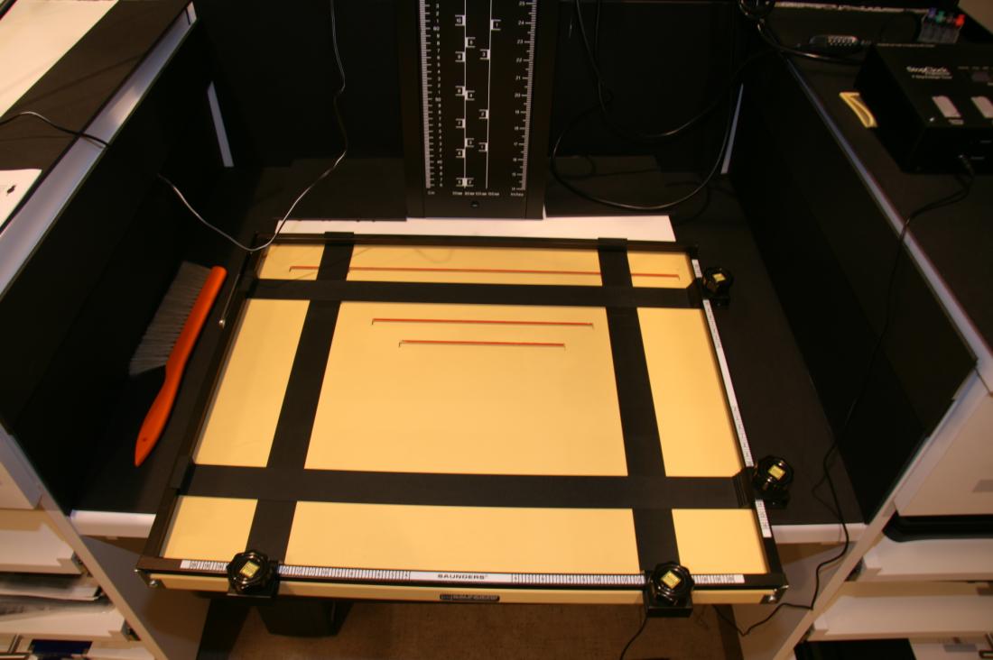

I have the same issue with my Beseler 45 VXL and 8 foot ceilings.
I had a 3 foot wide section of cabinet built that was just about 2 feet tall on which to place the baseboard. That cabinet is surrounded by cabinets on both sides to which they screwed stringer boards onto which I place a piece of countertop for the easel. For prints up to 16 x 20, I put the easel at the regular counter height. The enlarger is very stable so racking the head up high is no problem. For prints larger than 16 x 20, Iremove the piece of countertop and place the easel on the baseboard below. That is a bit awkward, but I only do this a few times a year. Saves raising the roof.
Be aware that roof joists are usually 16 inches apart on center and your light source is probably larger than that. so even if you can get the column into the new space, you might not be able to raise the light source to maximum height.

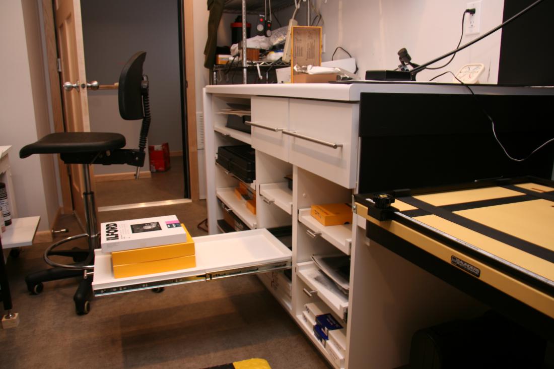

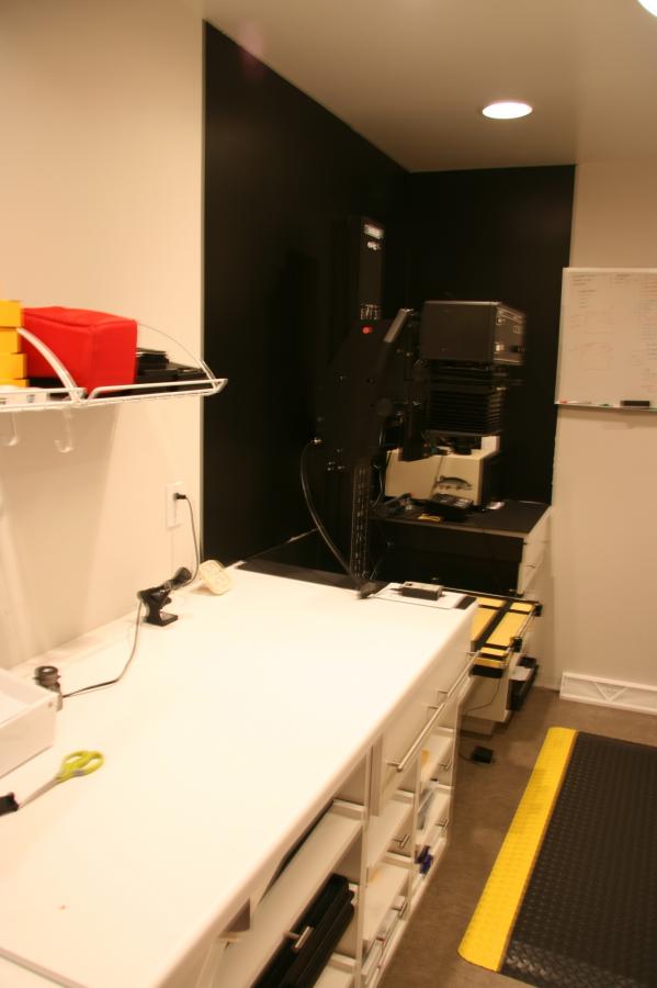

Here are some pics of what I did. Hope that helps. The drop table is a bit hard to see because I lined everything with black foam core. Also, I don't have a pictures with the piece of countertop in place but it fits on stringers flush with the main countertop.

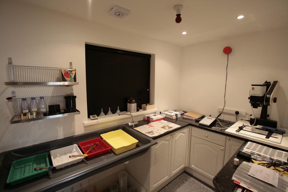

Yes, this is most definately the solution! Cheers Jerold! Mother dearest has spoken to the same carpenter that converted the loft and he's coming over on weds to have a look. It'll be a case of removing the cupboards along the back wall which you can that see in the picture and building a smaller stand beneath it. That'll leave a 3 footish gap between the cupboards along the left and the wall along the right where I can drop in a countertop. Does the drop-in counter have a hole in it for the column or is it slightly thinner and just sits in front of it? That easel is a beauty. I need to get myself one, only have a 12x16" at the moment. What are the largest prints you can produce? I'll be able to single tray process 20x24's in the sink I reckon. The calculations on the whiteboard are frightening. I'm learning nothing by using the splitgrade system but it's going to allow me to make bigger enlargements without wasting so much paper. Just need to spend a lot more time printing after this is all set up.
