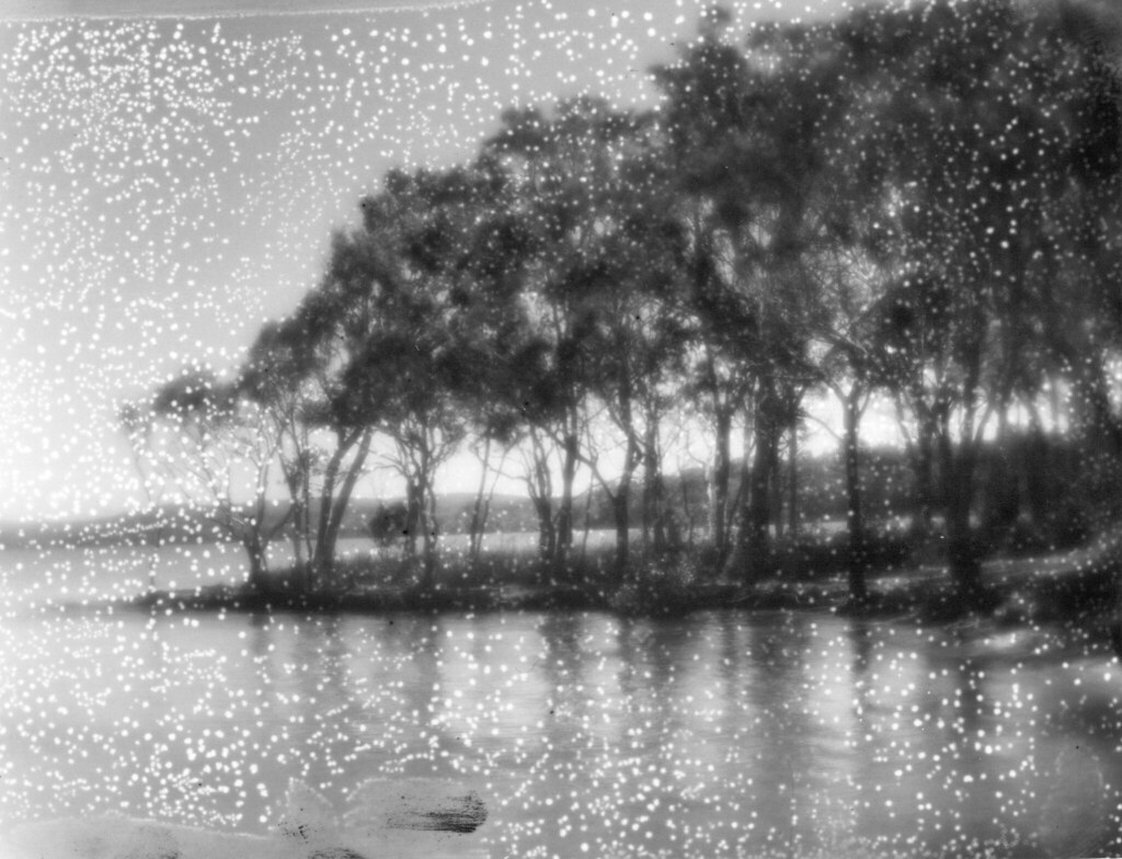

Gelatin-silver photograph on Ultrafine Silver Eagle VC FB photographic paper, image size 16.4cm X 21.3cm, from a 4x5 Tri-X Pan Professional negative exposed in a Tachihara 45GF double extension field view camera fitted with a 150mm f4 Wollaston Meniscus soft-focus lens and a #25 red filter.
My photographer friend died after a long long illness and some of his equipment passed into my hands. There were many film holders on a shelf that he had loaded with Tri-X fifteen years previously but could not expose. The film had corroded through the passage of years but I took it to those places we had walked with our cameras in times past and made some exposures.

what a wonderful tribute to your friend !

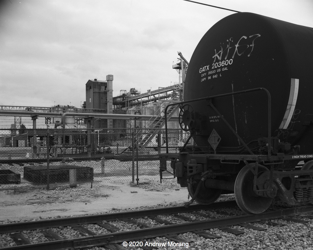

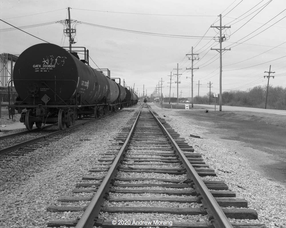

UPDATE: MAY BE OK. Here are two examples from the Port of Vicksburg, Mississippi. These display a minor amount of the reticulation, but a different pattern than Maris above shows. But the reticulation may be an error from the lab where I sent the film. The reason I surmise this is I used long-expired but frozen Tri-X in other holders. Some of the sheets were perfect while others displayed severe reticulation. I need to test again. On the second frame below, I see that I used a hood a bit too narrow for the 135mm lens.
