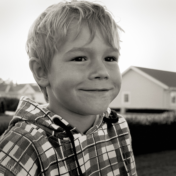

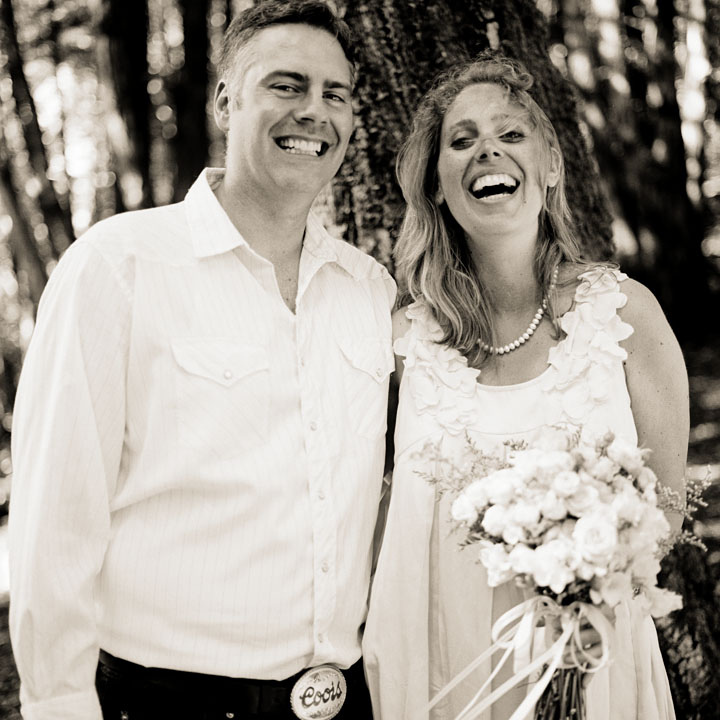

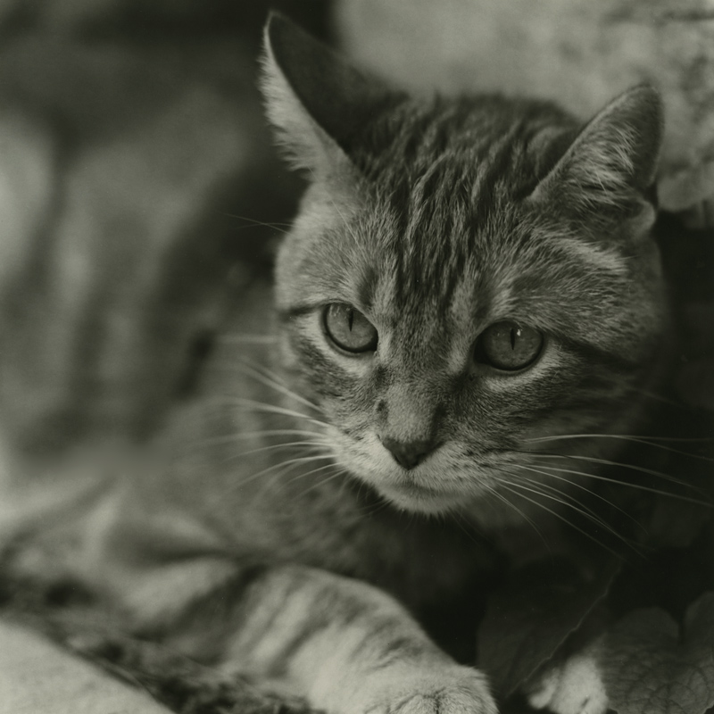

I'm sorry, but I cannot just stand by and look when somebody gives TMax film a categorically 'flat' verdict.
All of the attached pics are TMax 100 and 400 film.
They are not flat, because I took time to understand TMax film, how to properly expose and process them. All in replenished Xtol. You control contrast via exposure and development, and if you can't get enough contrast from the film, or as much contrast as you WANT, don't blame the film.
Back on track. Sorry to deviate from the original topic.

Well the cat looks flat, Thomas, in the sense of a certain worldly "ennui" that only cats can manage in portraits and they never charge extra for it.
It's a great look. No training required

Thomas,
That's a great shot of the boy. Grainless, crispy black and white in the shirt, perfect skin tone. Just great.
Jan 21, 2003
15,716
Switzerland
Thomas,
Thanks! That one's Pentax 35mm TMX in replenished Xtol. The other two are Hasselblad. Kitten is TMX and wedding is TMY.
