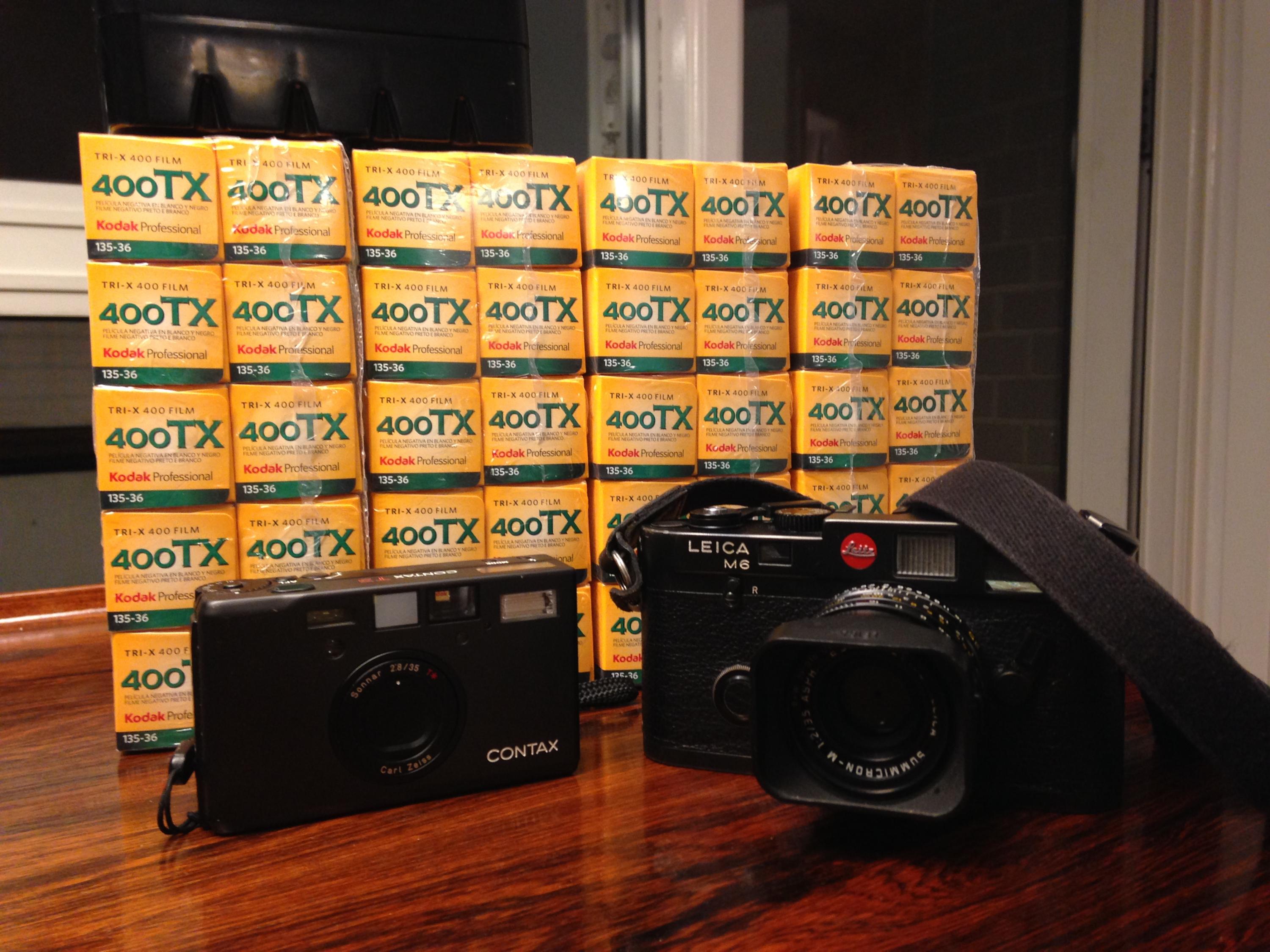

A quick update: I'm back home now. After selling some film and some gear (more film and gear to sell / selling on APUG right now!) I've ended up with this combination of things which is nice.
Travelling to Italy for 10 days or so in a couple of days' time, so excited to shoot there (M6/35/30xTX). I might share some photos of prints tomorrow too.

Not quite: I also have a Rolleiflex (for portraits) and some Nikon autofocus gear (for wildlife), as I mentioned in the first post. I've sold almost everything else now!
