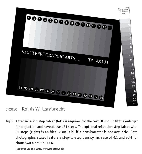

No. You take a picture of a transmission step tablet, such as the one from Stouffer (attached). This way you have ten exposures on one frame! The other benefits:
1. fine increments of 1/3 stop
2. no deviation due to shutter or aperture inaccuracies
3. no deviation due to illumination fluctuations
4. heavily reduced testing time and effort

Thanks for the pointer (in the image caption). I'd casually looked for exposure targets and only found things over $200.
One question, though. How do you take a picture of the transmission tablet? Project it on a white surface and take a picture of that?

You need one of these 5x4 Step Tablets - Dead Link Removed

Perhaps my question was poorly phrased.
I have a film I want to test, and I have this calibrated transparency. What do I do then?
Taking a reflected light picture of a transparency seems of little use. So do I put it on a light table? Project it onto a surface? Contact print it onto the film?
Get a 4x5 transmission step tablet (31 steps), tape it to a window or small piece of milky glass, get close and photograph it. Alternatively, get a step tablet in the size of your film format, mount it into a slide copier, and photograph it that way. Make sure your light source matches your type of photography. I suggest to use daylight or flash for the test. CFLs, fluorescent and incandescent bulbs have a different color temperature and return a slower film speed. The test results would not be applicable for daylight and flash photography. Set the exposure for the middle gray steps. Roll film users bracket to have a few extra frames and some data beyond the ten stops of the step tablet.
Get a 4x5 transmission step tablet (31 steps), tape it to a window or small piece of milky glass and photograph it. Alternatively, get a step tablet in your film format, mount it into a slide copier, and photograph it that way. Make sure your light source matches your type of photography. I suggest to use daylight or flash for the test. CFLs, fluorescent and incandescent bulbs have a different color temperature. The test results would not be applicable for daylight and flash photography. Set the exposure for the middle gray steps. Roll film users bracket to have a few extra and data beyond the ten stops of the step tablet.

ralph if you have a 4 x 5 31 step tablet is there any reason not to put it on top of the film you are testing and expose it on zone ten using a white back ground.
Mitch,
I know you asked Ralph, but that's how I do it and it has served me well. I use a white target close enough to the lens without any focus on the target while in the shade on a cloudless day or very even overcast day. I expose one sheet to determine the curve and the effective EI, then I expose additional sheets as necessary at the effective EI to determine "N" dev and other dev times. I believe it took me a total of 5 or 6 sheets to determine a family of curves for d-76 1:1 at the effective EI and in relatively short time to boot.
Mitch
As cporter already said, that works fine for the first 5 exposures to do the development test, because we after relative exposures, and Phis Davis did it that way, but it has one draw back: camera and lens flare are ignored. If you do it in-camera, you get a more realistic test.
The 6th test needs to be done in-camera, because you need to be able to relate the results back to ISO to get a usable EI.

Ralph,
Just wanted to make sure I was clear----what I was describing to Mitch were tests inside the camera for effective EI and subsequent exposures for development times. I simply put a 4x5 density scale tablet on the emulsion side of the film for all exposures, then slide both into the film holder, then photograph the target. I'm a firm believer of using the in-camera method with the tablet.
Ralph,
Thanks for the clarification. What an ingenious concept!
How do you make sure not to focus onto anything?
I set the camera at infinity (to avoid any bellows factor coming into play) but place it close to the target so that it completely fills the GG. I can't take credit for the concept, I learned it from John P. Schaefer's book: The AA Guide, Basic Techniques of Photography, Book 2.
