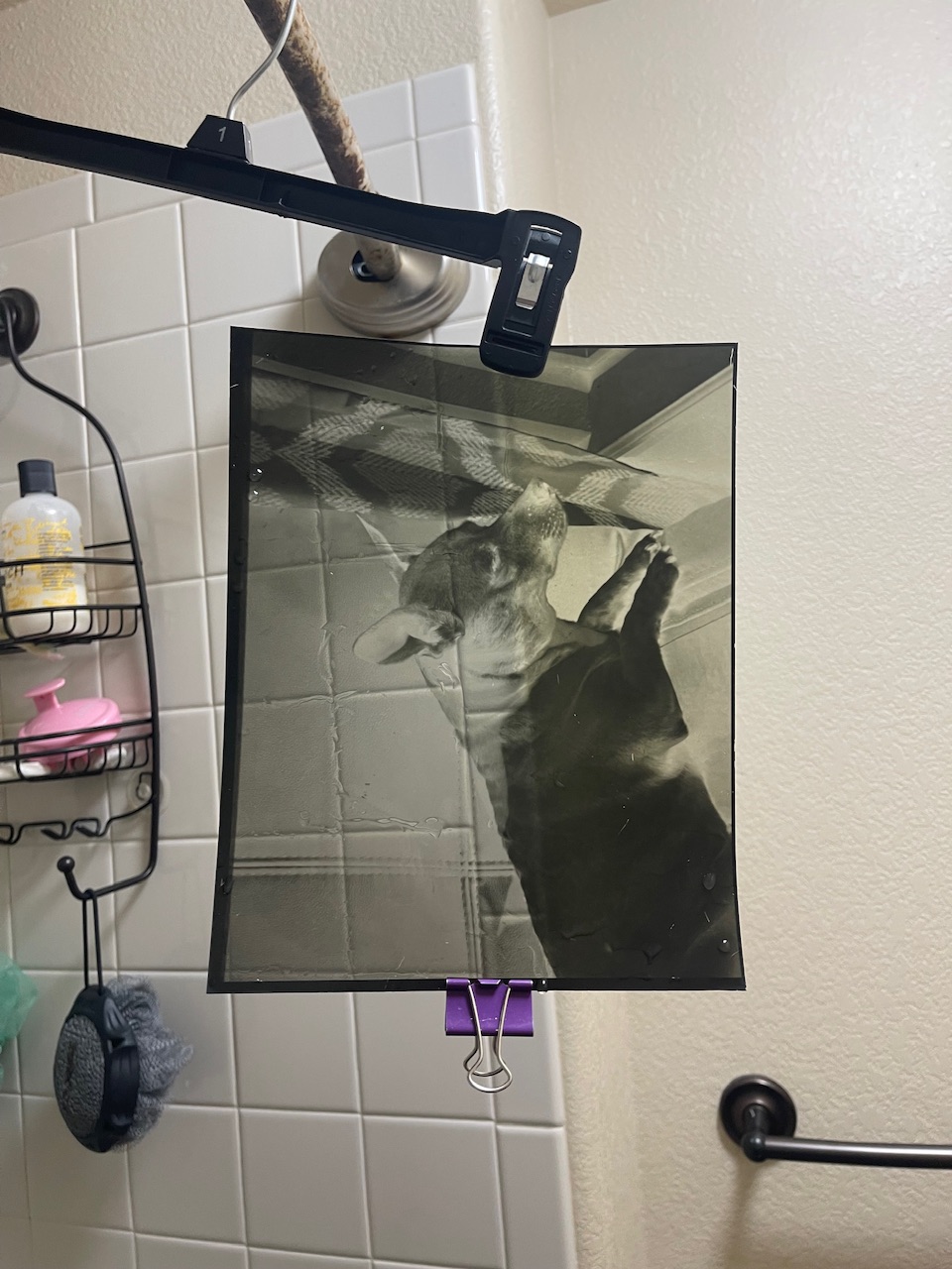

Well, I finally did it, I finally made a negative enlargement! And it looks very good! Also gave me an excuse to pull out my enlarger, I haven’t used that in too long…
50mm lens, f/5.6, 120 seconds exposure from Tasma 42L onto Kodak 2422.

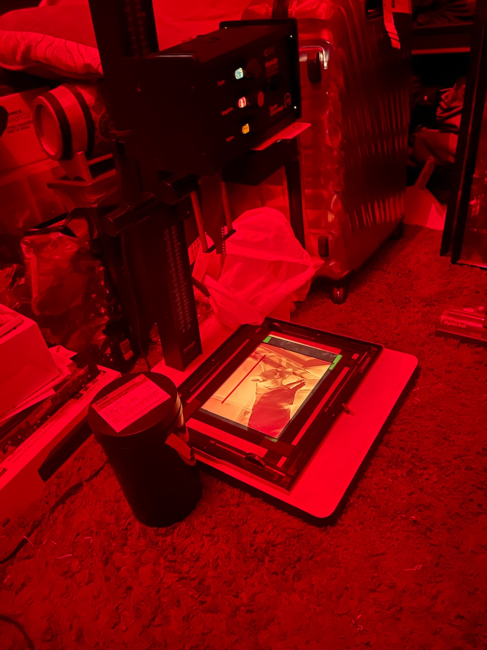

I just used it like any other enlarging paper, not much to it.

Splendid! Do you mind sharing your process?

A suitable image for the first enlargement! Fido surely appreciates the size increase :smile:
Another application for this would be to get more detail out of a negative that you're going to scan. I used to enlarge on 5x7 paper specifically for that reason.
