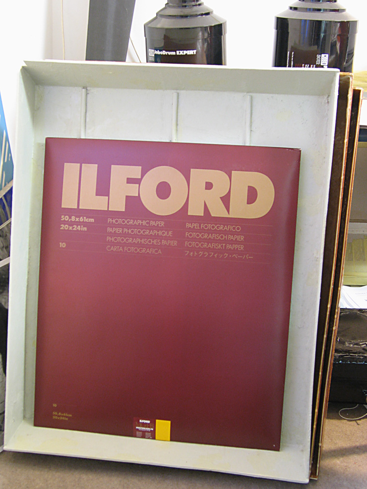

As others pointed out, drums don't work well for FB (ask me how I know). You could try making your own monster trays:
42983-one-huge-print-drum-_big_trays_.jpg.att
Plywood, epoxy and polyurethane.
Awesome franken trays!
