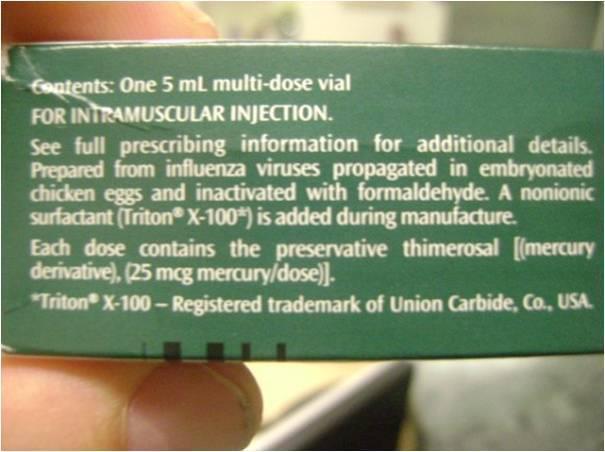

M.A.Longmore
Aug 25, 2009
2,024
Drinking From A Fountain
Whiskey Tango Foxtrot ? ? ?
Photo Engineer
Apr 19, 2005
29,018
Rochester, NY
Yeah, just like the old C22 and E4 stabilizer baths for color films (and papers). Except for the mercury!
PE
