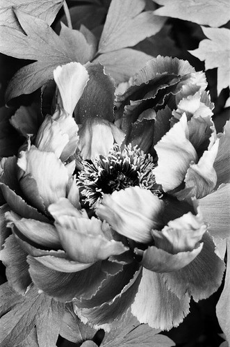

Is kentmere 100 really nice? I could bulk-roll it. I actually like the 400. It's 2/3 the Hp5+, and I push it to 800. Nice gradation.
Yes, it is.
I only use K100 and F100 in the Summer as in the rest of the year it is K400 and/or F400.
Here is a picture in K100:
18630011 by Ricardo Miranda, on Flickr
