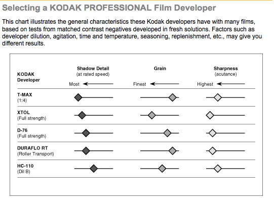

attachment.php
Here are some developer trades offs
