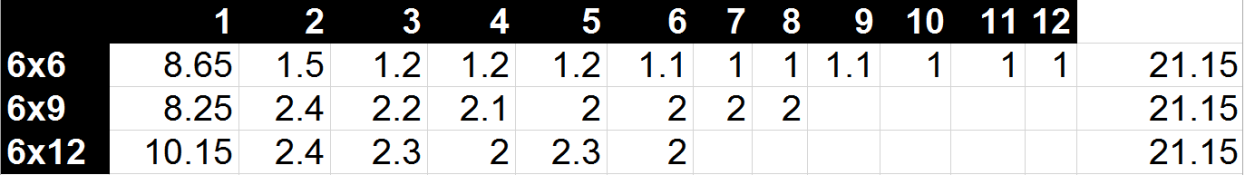

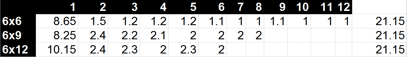

Attached, for what it is worth, is my crank turn count for my Ondu 120 MF
The 6x6 numbers don't look right but I added all turns across and come out with the same number of total turns as I do for 6x9 and 6x19
Methodology
I loaded a roll of film and advanced it until the big arrow pointed to the right hand magnets
I attached the magnets at the top of the back to the magnets at the bottom of the body so I would be able to see the film numbers move past the red windows
I placed a mark on top of the take-up spool winding knob
I advanced the film until the first frame number I was supposed to see in the red window for 6x6 appeared over that red window keeping track of the number of turns of the crank
I advanced to each subsequent frame documenting the number of turns from one frame to the next
I rewound the film and repeated for 6x9 and then again for 6x12
The film is back and I find that the first frame begins 1/3 of the way between the 3 and 4 upper edge markings (Ilford Pan F Plus) or that there is more than 1 6x12 frame of unexposed film at the beginning of the roll
I only got 5 frames on the roll (6 is you count the last frame being double exposed) and the trailing edge of the last frame is only 1" from the trailing edge of the film strip or just past the 19 upper edge marking
Frames are fairly evenly spaced with probably about 1/8" between them
There is fog in the lower corners of all images except the first and last
There varying numbers of consistently placed D-Max outward pointing triangles above and below each frame which do not appear to extend into the image and are probably where the black insert in the camera body is cut for placement of the wood pieces for setting the camera to 6x6 of 6x9 format
I think that I started by winding the film 10.5 turns to get to frame 1 instead of the calculated 10.15 which resulted on the large amount of blank film at the start of the roll but in any case I think my next try try will be starting out with 8 turns to frame 1 and a uniform 2.5 turns to all subsequent frames and be content with only 5 frames per roll, if I don't have better luck seeing the backing numbers of Arista, Foma, Fuji, or Kodak
