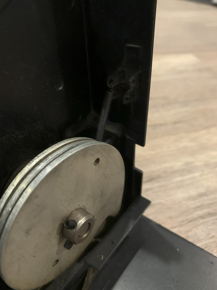

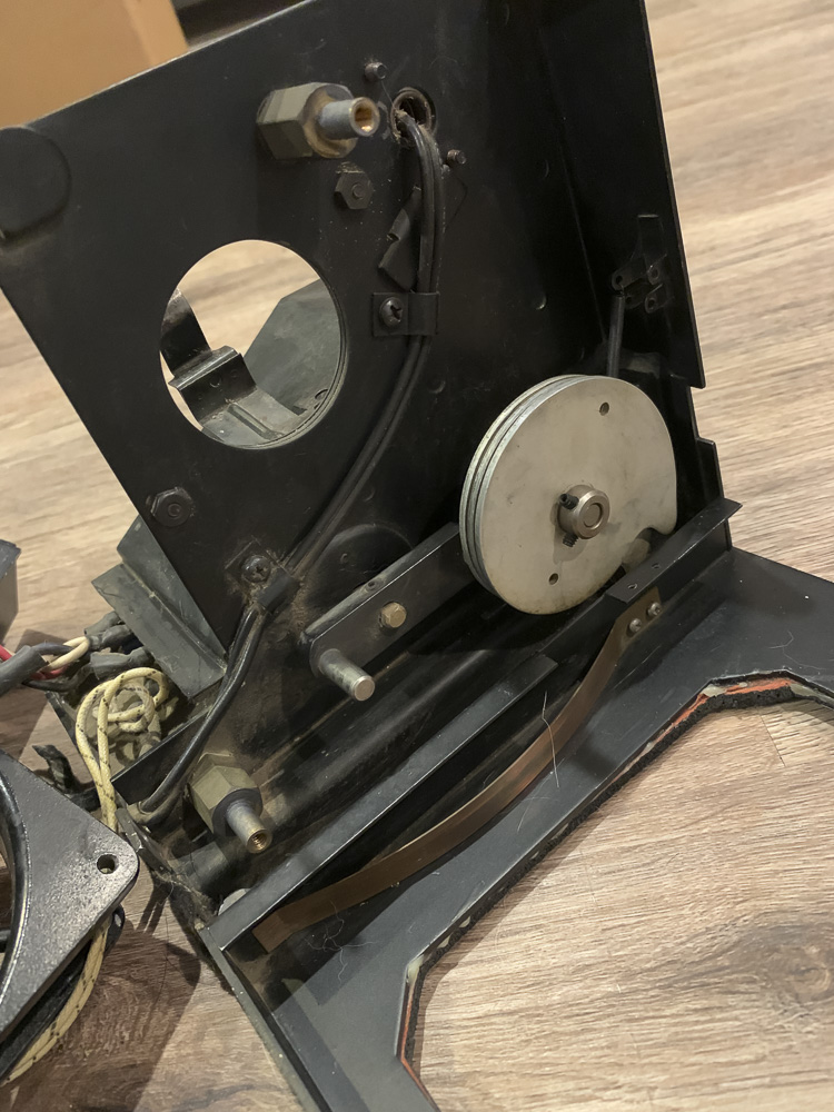

I was gifted an old and dusty Omega D2 with the first Super Chromega Dichroic head. Because of it's condition I decided to take the color head apart to clean it. Of course I didn't take any reference pictures to help me put it back together! Does anyone have a service manual for the color head or an exploded view to help guide me. My main issue right now is putting the dichroic filter arms back in the correct order and which holes the different springs should go to. I've attached some photos so you can see where I'm at. Also, besides cleaning out the dust is there anything maintenance wise I should be doing at this point? For instance, should I be applying a lubricant to any of the internals? Thanks for any help folks can give!

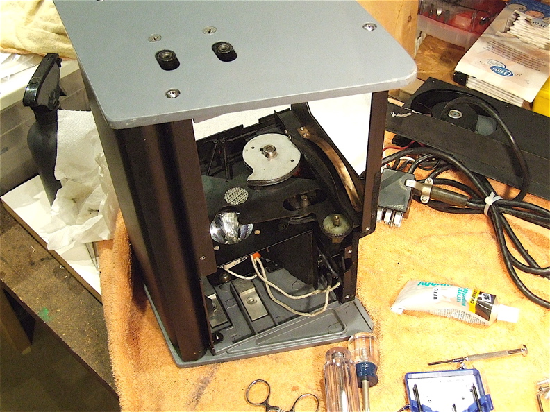

With the head facing you, from left to right the wheels under the head are Magenta, Yellow, Cyan. Match the cam controlled by each wheel to the same colored filter as you stack them together. If you can't get it back together, I see a few members looking for the scrim and some of the filters.
