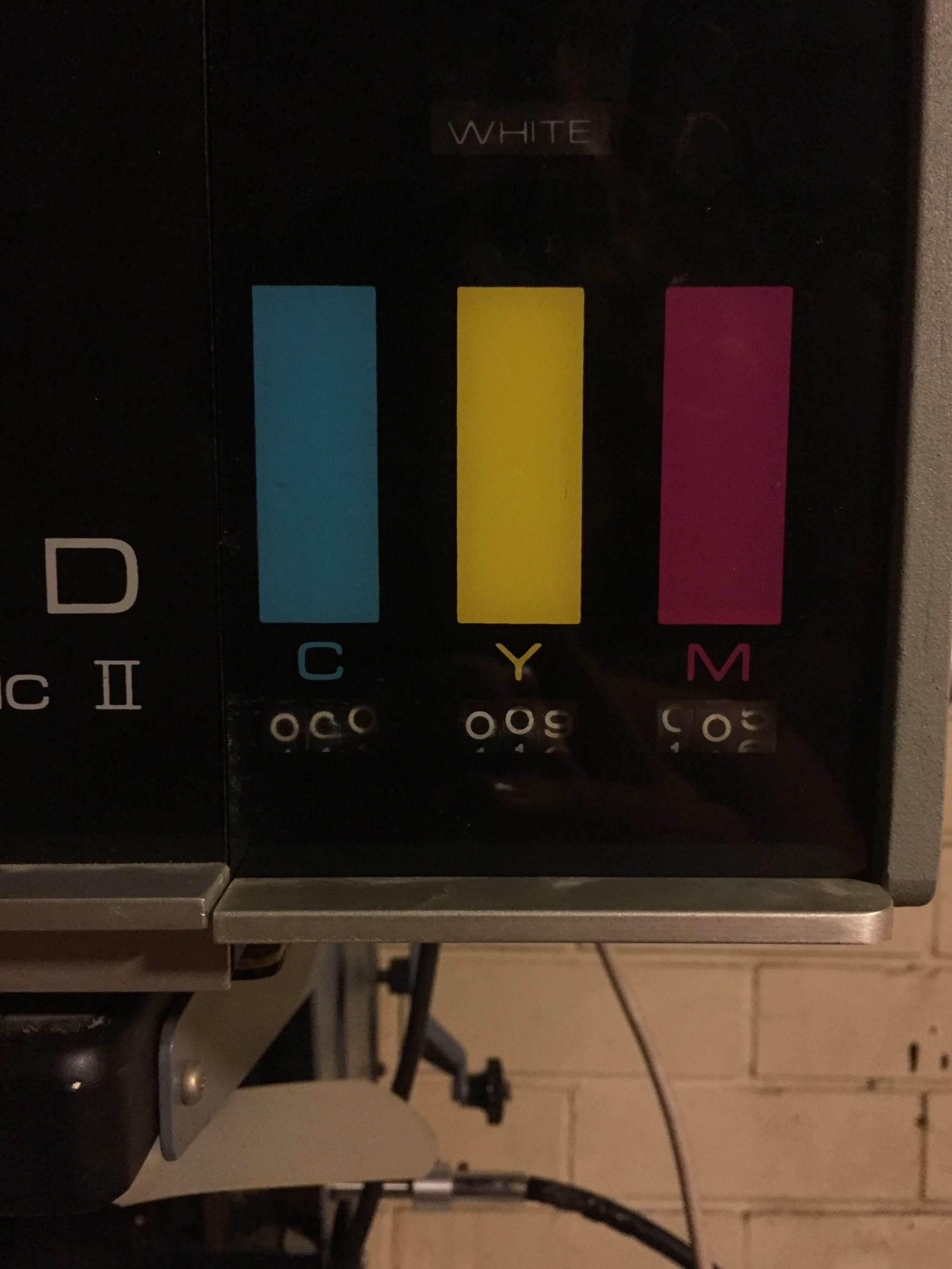

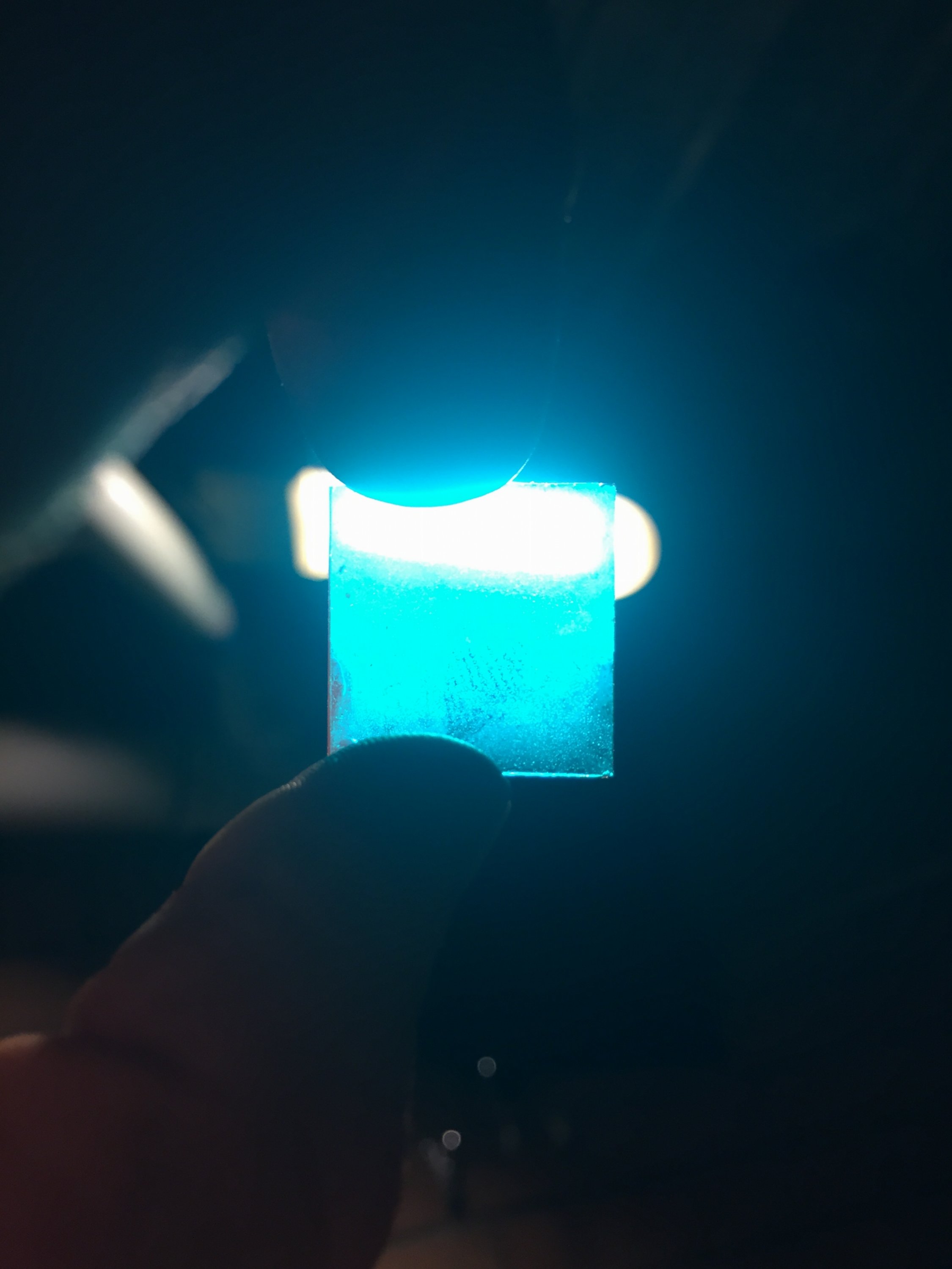

Another thing is, the cyan filter fell out of its place during assembly, and the colour wheels don't return to zero, instead they return to about 7 or 8.
How do I reset the colour wheel display, and how do I put the cyan filter back in?

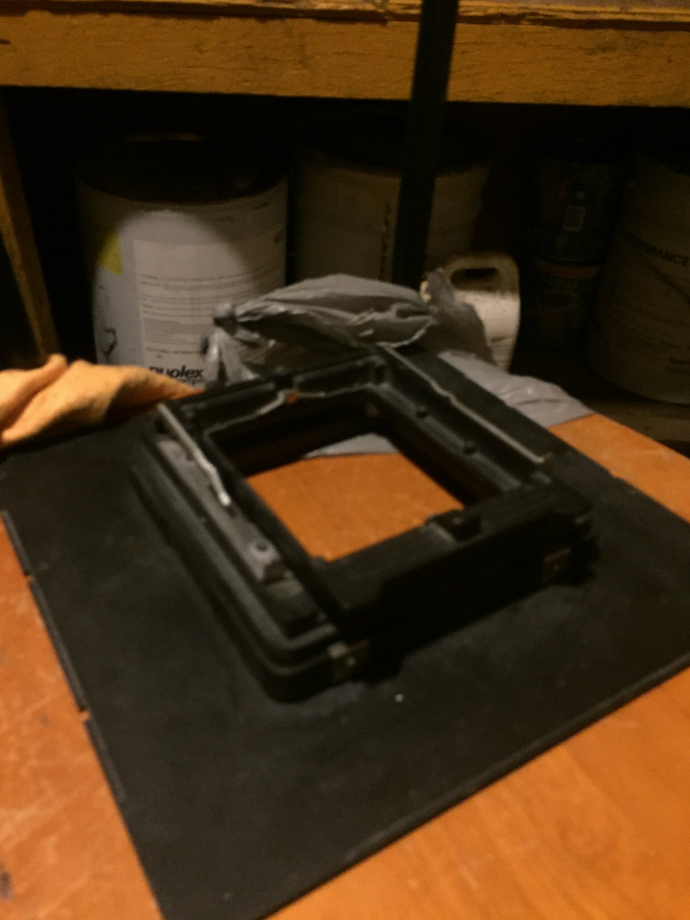

Any information will help, as 15 yr old me is too stoopid to figure this out, cheers, oscar

i took apart the head and stuck the filter back in, fairly simple task, but with a big enough jolt it will fall out again which I'm not overly worried about. I also found that there is a flat head screw below the colour wheels, which disengage the gears, meaning you can reset the wheels manually before tightening the screw back up.

I stuck my cyan filter with some kind of high temperatur clue or kit back in place and it was fine. 240 Volt power supplies are hard to find, I was searching half a year on ebay until I get one. I remember there was one in australia too at this time for around 20$. KHB Photografix in Canada is selling all kinds of replacement parts for Omega enlargers too.
