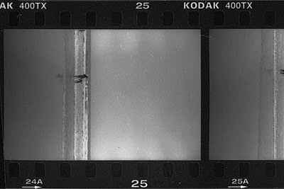

Yes, you need to use both reels, and fill the tank with developer, too. This prevents odd agitation effects from the tank or the developer aggressively shooting from one end of the tank to the other, jetting developer through the sproket holes:
(photo from http://blakeandrews.blogspot.com/2010/06/brief-history-of-sprocket-holes.html
