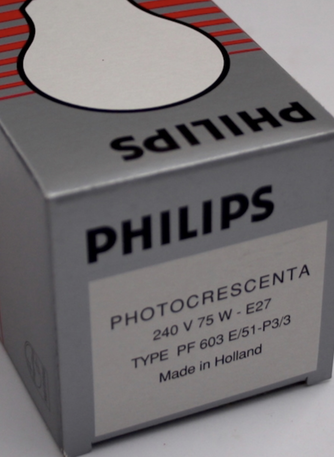

Thanks very much for all the replies. Ok so maybe I can just replace the lamp assembly with a 240v lamp head and put a 75w bulb in it like the one in this image?
Huub
Dec 4, 2007
250
Yep, that is the kind of bulb you need.
