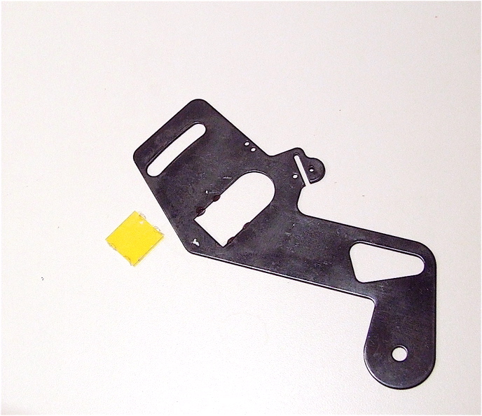

When I repaired mine I believe I used silicone glue.

We’re you just reattaching, or did you find a replacement filter?
Just re-attaching the existing filter.

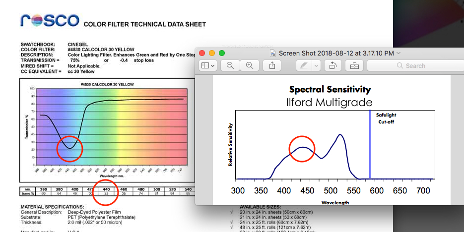

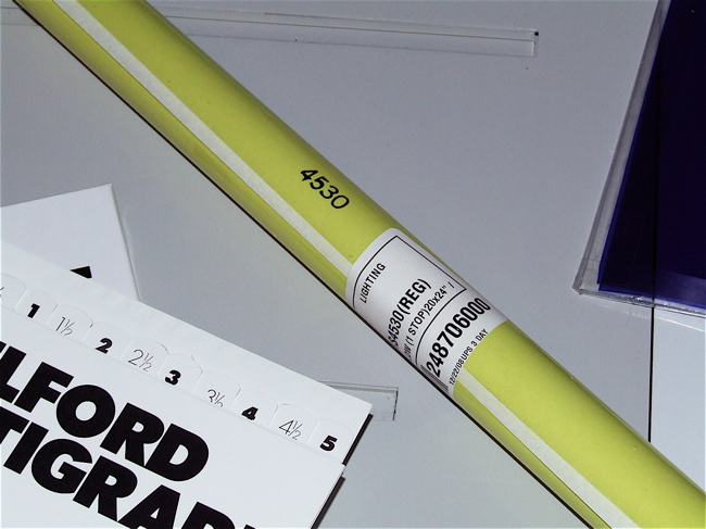

You don't need an exact matching filter. Any yellow CC filter should do for either B&W or color, unless you are planning on reproducing existing prints with notes on filtration.
Have you priced new dichroic filters without the holder? $100 for one already attached to the arm is reasonable, and may be more cost effective.
If you are on a budget, get a 20"x24" sheet life-time supply of Rosco 4530 Yellow for $7 and cut a little square. Replace it when it deteriorates. The first generation Chromega color heads did not have dichroic filters.
I like this idea. Lighting gels stand up to heat reasonably well for awhile. And as ic-racer points out you don't need exact filtration-- you're going to dial in whatever is needed to get the contrast/color you want anyway.
