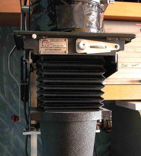

I have the masking blade set and a D-II, and indeed, it doesn't work directly on the negative stage, BUT, if you have the distortion correction attachment (tilting neg stage--cat. no. 7439) it will fit on the neg stage, and the masking blade set will fit on top of that.
BUT WAIT! THERE'S MORE!--The masking blade set interferes with the long lever for raising the enlarger head, so you need to bend the lever around it.
In the attached photo you can see from the top down--condenser collar with an Arista Hi-D cold light head, wrapped with my custom non-image light attenuation shield (made out of a plastic photo paper bag and gaffer's tape), masking blade set under that (some of the knobs are missing), tilting neg stage, then the regular neg stage. Note the bent head-raising lever on the left.

I've been ogling that tilting neg. stage attachment ever since I saw in on that Glennview site years ago..
Does it come in handy? Also, do you have the easel that goes with it? Nice set up David!

I don't have a tilting easel, but I do have a stack of quarters...I mean...easel shims. I don't use it that often, but once in a while it comes in handy. I think I got it with a lot of other Omega bits and pieces.
