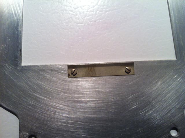

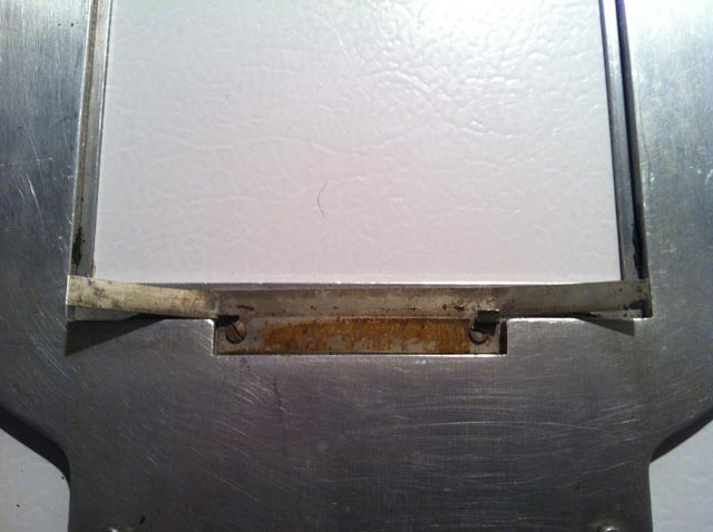

I am finally setting up an Omega E3 I picked up many years ago. I have a question about the 5x7 negative carrier, and that is: how does it go together? When I got it there was a piece of glass taped to the top half, and nothing on the bottom. There are clips on the top, and springs and clips on the bottom. See attached pictures.
I assume the glass goes on the springs, but the piece I have doesn't fit (but it's probably not original). Then I assume the negative sits on the glass without a top glass, since the clips on the top piece don't look like they could hold a piece of glass. Does this sound right? What is held by the top clips?

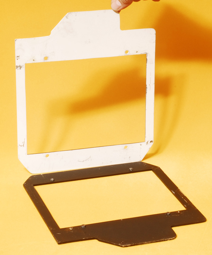

Looks bogus to me. I think the correct one should look like this:
43515-omega-e3-negative-carrier-big_2.jpg.att
I think my E3 is older than that. The 4x5 and the 3x4 carriers are the same shape as my 5x7. They all fit perfectly in the enlarger. So I think they are the correct ones. The tab on the one you show would hit the supports on mine.
My mistake. I recall now that there were E3, E4, E5 and E6 enlargers.
This is my guess, based on what I have seen in other carriers. There is a Durst carrier in which you are required to lay the negative on the bottom glass with frame and then lay a piece of glass on top of the negative, then sandwich it all together in the top frame part. So, in this picture, he is holding that free top glass piece with his thumb. Also, see the springs on the top frame that press the glass pieces together.
I'll suggest your frame works in a similar manner. So, you mount a flat glass to the bottom frame and use a free glass on top. Then press it all together with the top metal frame.
the glass goes on the bottom
and the glassless goes on top.

Thanks, that makes a lot of sense. Kind of odd to have the springs on the bottom from an alignment standpoint, but I bet it works fine. I'll see if I can get some glass cut for it.
