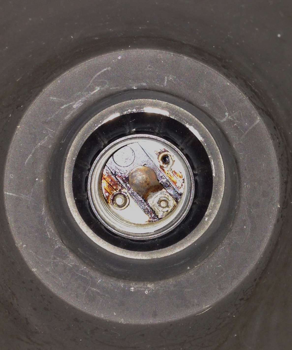

I finally had a chance to look at the bulb socket and it's got some brown burnt looking stuff on the contacts. The bulb is a 150 watt. I've seen that replacement bulbs for these come in both 75w and 150w so I don't know how to tell which is appropriate for this socket.
I wiped everything down and will let the enlarger sit until tomorrow most likely before trying again. Does anyone know if these burnt spots are something I can clean or do I need to replace the socket?
If anyone has experience with different versions of lamp houses for these DII, I have the "color head" version that has a filter door above the condensor.
Thanks again to all of you for your help!

Are the brown spots burning or rust/corrosion? If the wire is in good shape you might get away with using a good wire brush on it. U plug it!!!
My socket is a standard lap socket that screws in the top - standard lamp socket available at any he store, and easy to replace with minimal expertise.
I apparently don't have color head version as there is no filter drawer above the condenser. Also I use 75w bulbs only.
