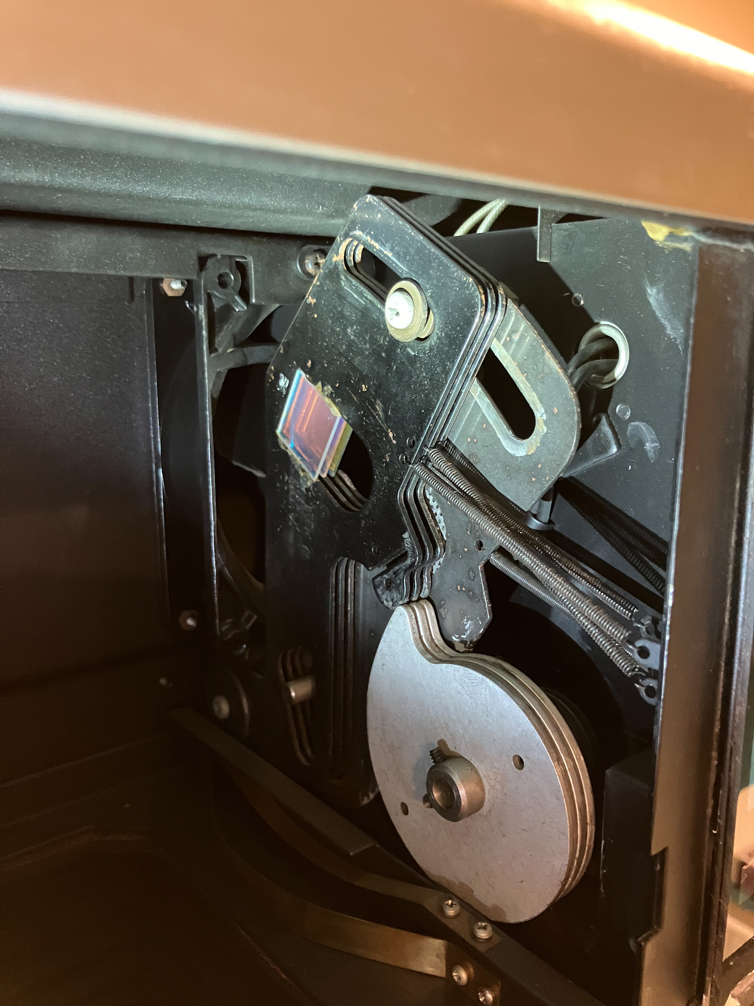

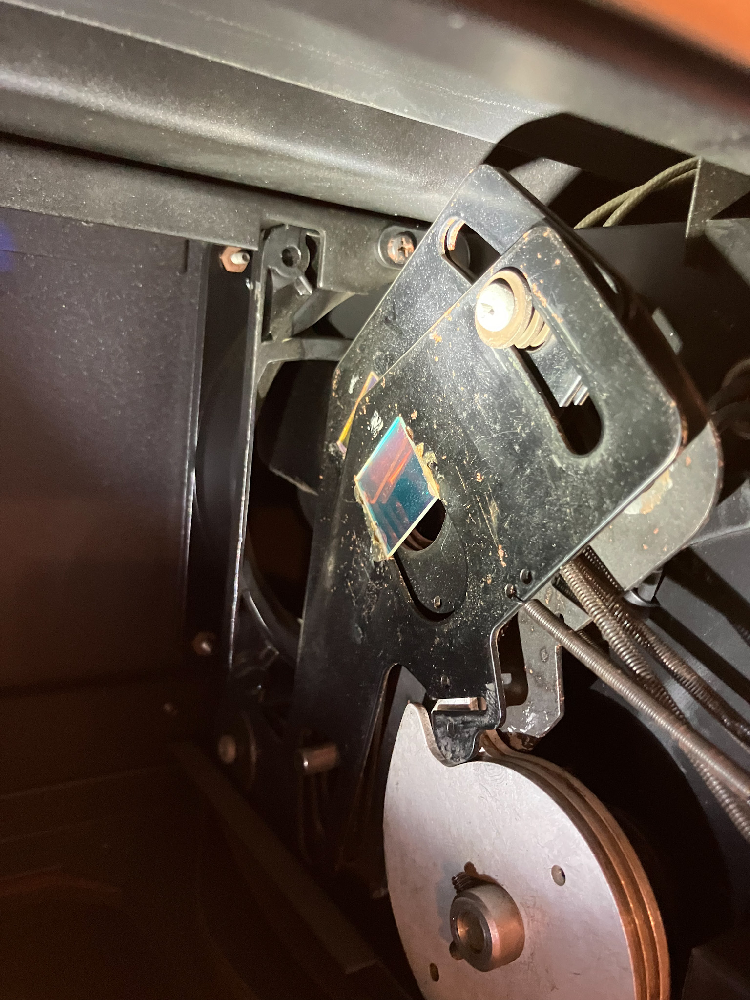

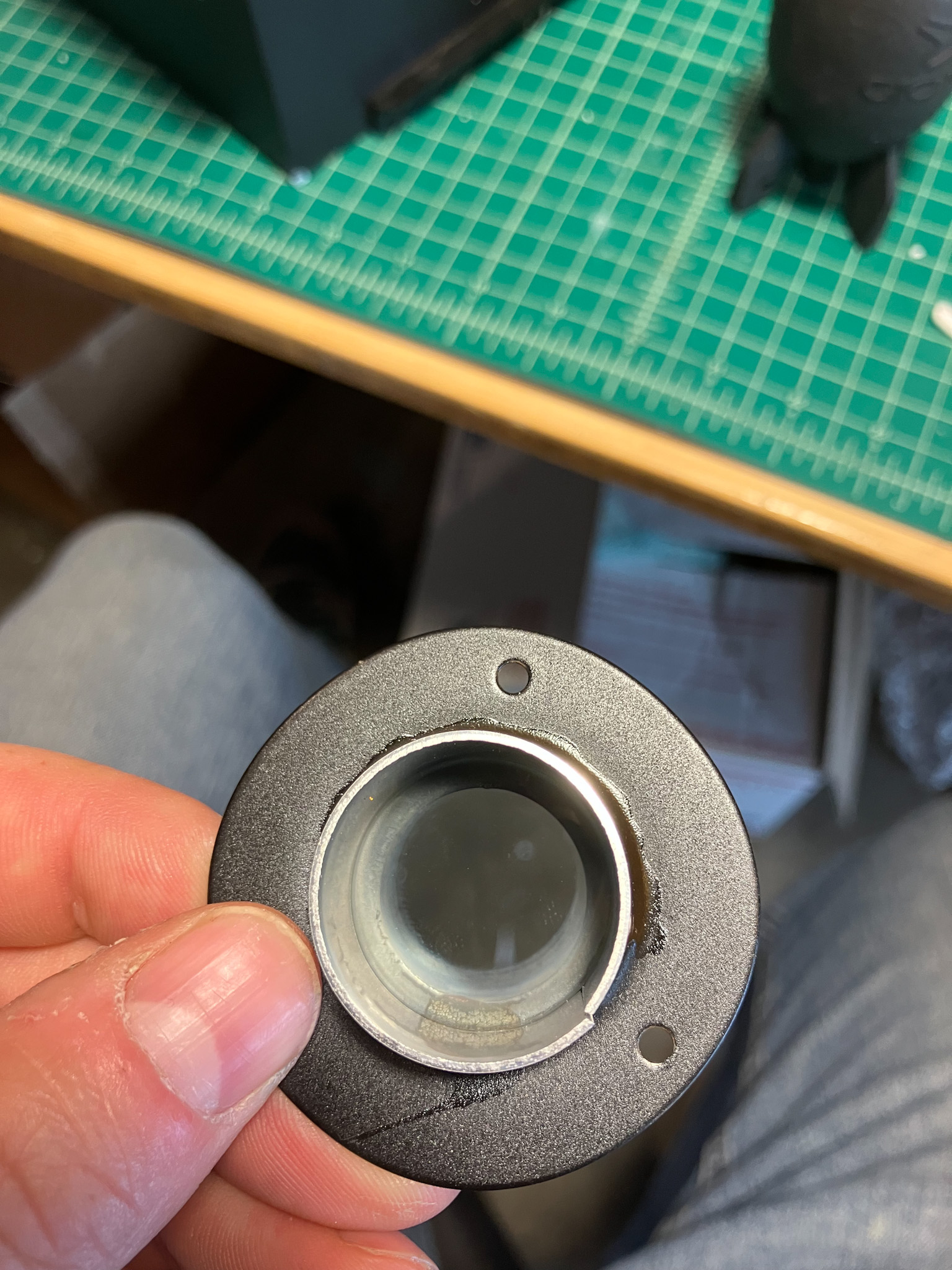

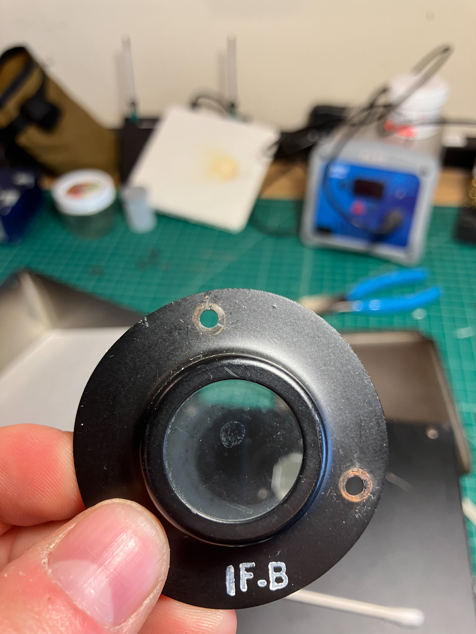

I’m chasing some contrast issues with a new to me Omega D5 enlarger with the Dichroic II head.
I have both the DD (4x5) and DB (6x7) mixing chambers. Both have IR filters and both seem to be in pretty bad shape. I’ve attempt to remove the haze with standard lens cleaner and have had no luck.
Other than KHB I haven’t seen any for sale.
Curious if other folks have experienced this, if you think it’s an issue worth repairing, and if you have any thoughts.
Thanks!

I suspect you are only losing fractions of a stop. How long are your exposure times?

Not long, 20-30s at f16 on ilford fiber warmtone gets me to d-max.
Exposure times have been very workable, just battling low contrast and have been doing some clean up. Replaced some yellowed styrofoam in the mixer and noticed the filters.

I'd just do as you are doing; clean them the best you can and not worry about them.
If contrast is low can you confirm the yellow moves all the way out of the path on 000 and the Magenta is totally covering at its max? How is the lens? Any fog? Are there any light leaks in the head? Fresh developer and paper?

I can confirm yellow moves all the way out, and magenta all the way in.
The lens isn’t perfect but I don’t think it’s the issue.
The paper was purchased new by me in the last 6 months and stored in a cool dry place. The developer was freshly mixed from a newish jug of ecopro paper dev.
Now while I’m taking pictures here I do see that the filters themselves are pretty nasty! I’d blown some compressed air in there before but hadn’t really looked hard. I cleaned up the magenta the best I could, but I wonder if I should be pulling the filters out to give them a proper cleaning 😬

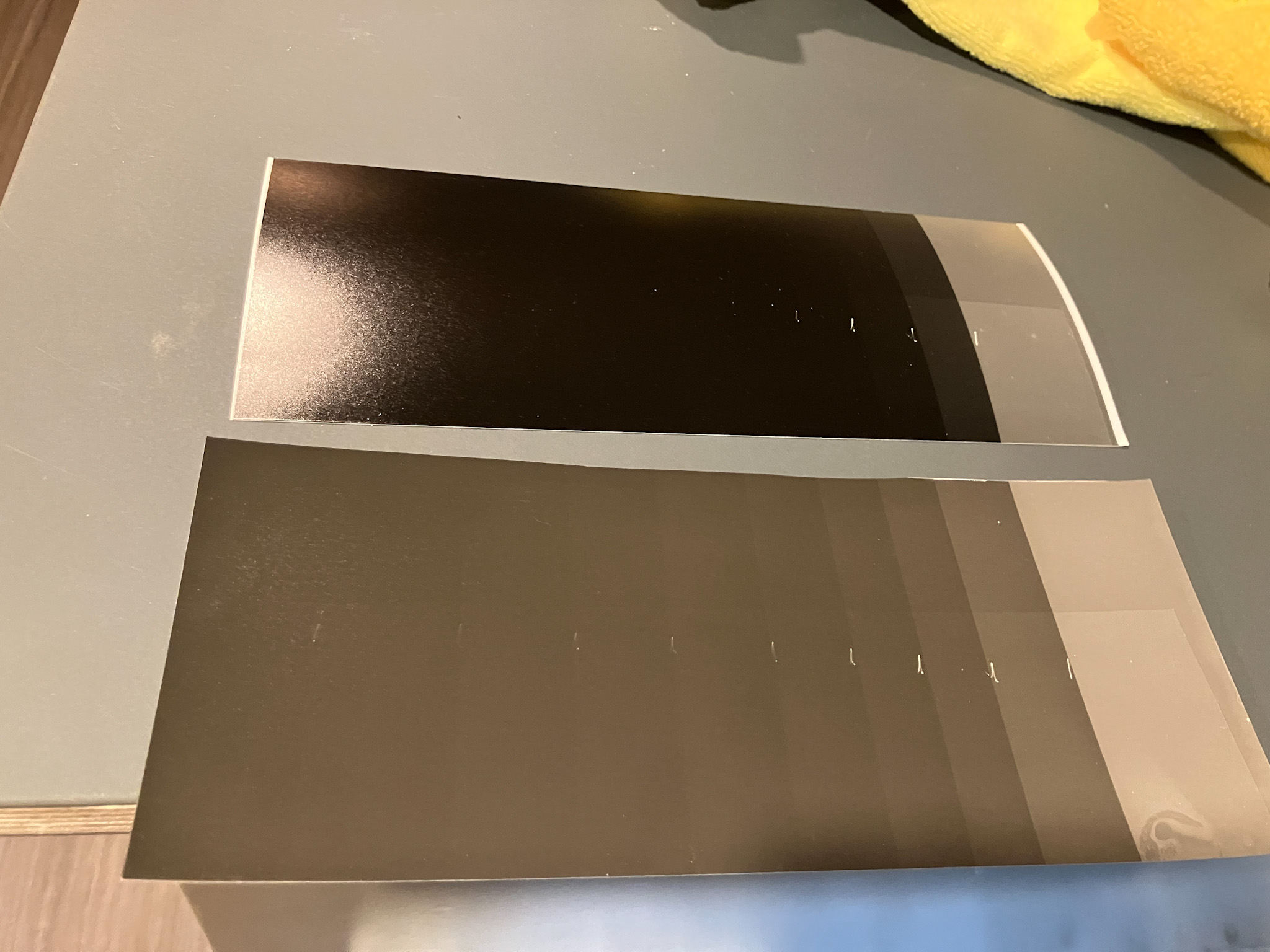

To check your contrast generation from the Chromega Head, you can contract print a step wedge at maximum magenta and see how many gray bands you get. That will let you know if the head is generating adequate contrast and eliminate any loss of contrast from the lens or from flare or light leaks.

So I only got one test print before the bulb started getting weird and subsequent tests don’t seem valid. At 150 magenta (not max but whatever 150 means) I get 8.5-9 steps. But I’d love to compare it to Y41, M32. Guess that’ll have to wait a bit for shipping.

Dichroic on the left, ilford filters on the right. “C2” on the top “C4.5” on the bottom.
I didn’t get all the exposures lined up the same, but the good news is that the number of steps in the dichroic and ilford tests line up perfectly.

The CMY filters in general are quite dirty and have no doubt lost some of their efficiency. They certainly look geriatric. But you have to use extreme care cleaning old ones; the coatings might be fragile. Dichroic filters don't fade per se, but with colorheads that old and corroded, a certain amount of spalling off of the coatings has undoubtedly occurred, along with the grime build-up issue. It's obviously been previously used in an overtly humid environment, probably a poorly ventilated sink room.

Yep, I’ve got Magenta pretty clean as it’s easy to reach without messing with anything. The question now is wether it’s worth attempting a disassembly to clean the other filters when it seems I’m able to get pretty reasonable results 🤷

That's good. Magenta is the most important one if high contrast is your priority. And you could access at least some of the other two filters just by dialing things out of the way and using a Q-tip. How much further you might want to risk it is up to you. I'd probably stop at that point if only VC printing is in mind, and not color printing per se.
In terms of other tuneup issues, avoid any lubricants which could potentially leave a flammable residue.

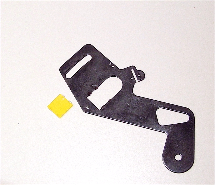

Once you start cleaning, you may find the filters pop out and will need to be re-glued.

Since you tested it, you now know your color head is performing as it should.
