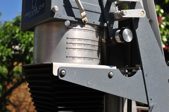

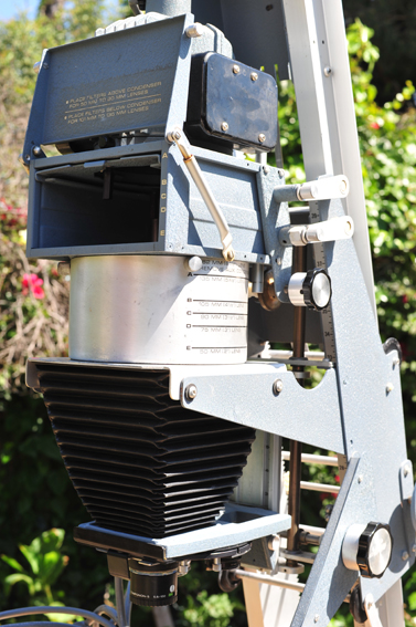

Hi,
I just received a D6. The seller left the small condenser in place instead of separate package and condenser is in pieces....
Do you know which part number is this one ?
If someone has a spare...? Miracle ?
Thanks,
Guillaume

that is rough... I had a D6 for a while and it is a nice enlarger. What formats do you plan to enlarge? For about a 150mm lens I believe that Omega recommended removing the aux condenser anyway so for 4X5 you might be ok. I know that when I had it at least for smaller 6X6 enlargements (on 8X10 paper) I preferred the 150mm lens over the 80 because it gave me more room to work under the head. That being said the two places that come to mind are KHB Photografix and The Darkroom Studios. A google search will give you the website for either. The Darkroom Studios have n ebay store with a whole bunch of enlarger parts and such they are clearing out (there is a link on their home page). They might have what you are looking for, I would try emailing them too. Good luck!
Skorzen
Jul 25, 2007
58
USA
Sent you a PM with a couple links that might help you out. PN for the lens alone is 472-104 for anyone who might need it.
