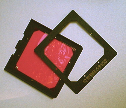

O.K. Thanks to a digigizmo that I am currently borrowing from a friend, I took a picture of the holder that I got with my D2V. It takes a 5" filter. I cut down 6" Ilford filters and I rarely bother using the top plate
The printing at the bottom of the top plate says:
"Filter holder should only be used in position No. 3. When condenser is in position No. 3, Place filter holder on top of condenser."
