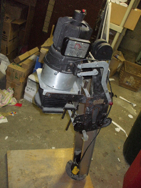

I should have done some more research before buying this, but at $45 I thought I should grab it first and worry about the rest later. I already own a Saunders LPL 670 so my goal here is to use it for 4x5 and maybe also 6x9. I have an El-Nikkor 105mm lens, a 50mm, and whatever this thing happens to come with. Any guesses as to what I need to make this enlarger usable for 4x5? Will the 105 lens be usable? Do I need a different lens cone (found reference to that on-line, what is it?) If I'm not lucky enough to have the right condenser set in there for 4x5, will the one there be usable (and at what impact) or do I need to find the right one (or ones)? What do I need to look at when this arrives? My goal is to hit the ground running and be able to start using it as soon as possible.
Thanks,
Dan

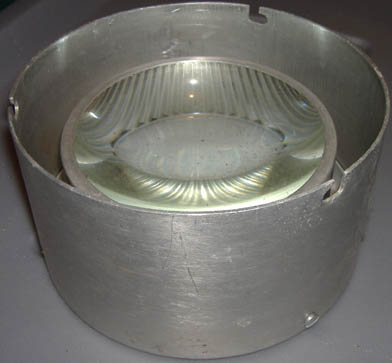

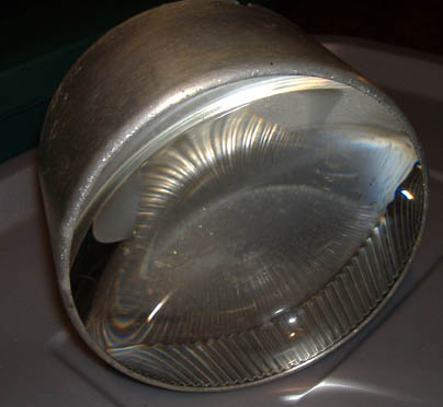

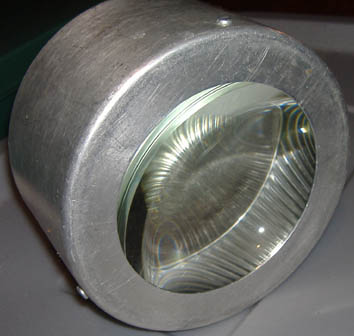

Dear Dan,
The 4x5 condenser for your enlarger has two lenses that just fit in the stainless steel cylinder (they are separated by a corrugated metal ring).
Here are photos of my condensers for 6x9 and 4x5.
I apologize for the focus but the attic lighting makes it difficult for my little digicam to autofocus.
Neal Wydra

I thought the only difference between the D2 and the DII is in the gear mechanism on the D2 for raising and lowering the head? Mine is a D2. It came last week and it's sitting in my garage assembled, but dirty. Everything works but I definitely need the long cone and a 150mm lens since it's set up for 35mm.
Dan
