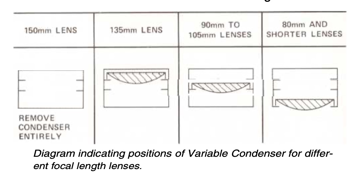

You don't need the top lens, it just concentrates the light a bit more for medium format and 35mm, your exposures might be longer. The spacer for the lower condensers is just a sheet of corrugated aluminum curved to the inside circumference of the outside cylinder.

Thank you for this info. That makes me feel better. I'm still learning about things. I don't mind printing longer. If that's what the top lens does then I'm good. I thought it was more critcal for the performance of the enlarger. I've seen that corugated ring and that should be pretty easy to make if worth find the material. Do you know the height? I can do the math on the length and cut it to size.
Thank you, I've seen this but I wasn't sure if these guys are selling or this is just an product info page. It doesn't look like online store. I'll contact them and see.

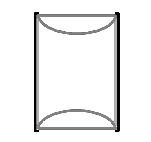

The height is enough to keep the flat side of both lenses facing out--so there is no space between the inside edge of the cylinder and the flat side of the condenser lenses.

Thank you Pieter!
Found some photos and user manual. I did the math and got the measurements. Just have to find proper material.
