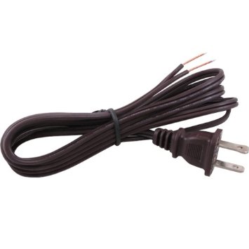

Ahhh! Sweet! The light bulb burned out! ha ha! now.... where'd i put the spare?
The lamp that sits on the Condenser head is pretty simple, just a lamp socket with a wire coming out of it. Should be an easy fix, or another one could be had for very cheap. The CT40 should work fine with the condenser head.
Hi Dale, the D-II has a condensor which is what i wanted to use because it is sharper. I figured out what was wrong. the cord coming out of the enlarger is loose and if you wiggle it, it shorts out.
Too many things going on at once I guess. Silly me!
Inside the head should be a socket like this to which a new cord can be fastened; very similar to repairing a lamp:
