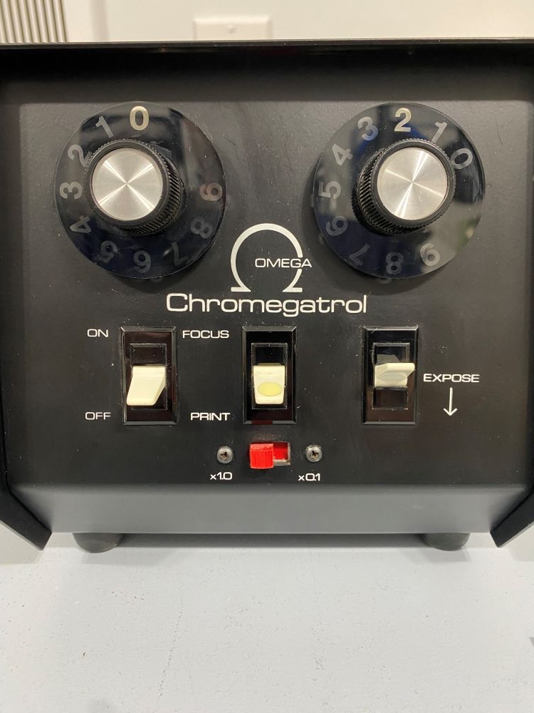

Hello all:
I do not use or have any Omega Chromega heads so I am not sure how this timer / power supply should function if not connected to the Chromega head.
With unit turned ON:
1) In FOCUS position there is a hum/buzz (not unlike a Gra-Lab 300 buzzer on a low setting), if EXPOSE switch is used the hum/buzz continues
2) In PRINT position there there is no hum/buzz, however when EXPOSE switch is used there is a hum/buzz but it times correctly and the hum/buzz stops at the end of the selected time.
I have taken it to an electronics repair shop with the schematic I found on line but they advised that without the Chromega head they could not test any further.
Model number is 412-040.
Is this normal if not connected to the Chromega head?
Thanks in advance.
Todd

As far as I know, the Chromegatrol is dedicated to Chromega heads. It is not a stand-alone timer that can be used with other heads.
The buzz you are hearing seems to correspond to when the enlarger head lamp should be powered. That circuit is not complete, since you don't have a head plugged in, so the buzz may be some consequence of that, or maybe your unit just buzzes a little when the bulb circuit is on.
The actions you describe suggest that the unit is working properly, but you won't know for certain till you hook it up to the correct head.

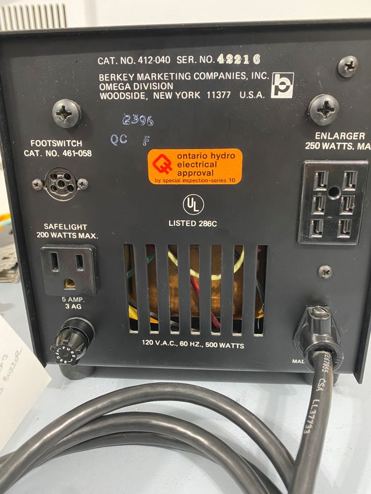

It is pretty easy to test, it is not an 'electronically regulated' power supply; just a ferroresonant transformer with a timer. Do you get 22.5V AC at pins #8 and #9 or across the secondary of the transformer when the "Expose" or "Focus" buttons are depressed?
Ferroresonant transformer (or just about any other large transformer) will hum when operating.
Usually these units fail in the timing circuit, not the transformer, so I'd be sure to test the timing circuit before getting the head.
