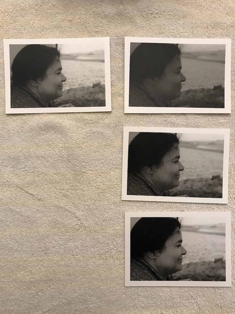

Well, I will be a monkey's uncle....
I just did some test prints with a single sheet of 0.005 double sided matte Dura-Lar in the filter tray, and a single round 3.5 inch sheet of the same sitting directly on the condenser assembly without the optional 35mm lens assembly, and gained a full grade.
The image on the top left below is the print from the other night at grade 0.5 with only dura-lar in the filter tray. The image directly to the right of it is the same 0.5 grade (with exposure adjusted to produce the same black level as the first print). Clearly dark and low contrast. The right hand image below the top right image is the same print, but grade 1,0 (with the exposure adjusted to produce the same black level as the print on the left). The sky in the upper right part of the image is clearly darker than the sky in the top left image (meaning the total contrast is lower, because the black level is the same). The image on the bottom right is the same image, but grade 1.5 (with the exposure adjusted to produce the same black level as the top left image). The sky on the upper right is ever so slightly lighter than the sky on the image of the upper left, so it's just a smidge more global contrast, but close enough in practice it will make almost no difference.
I would say if you want to turn an Omega B-22 into a diffusion light source enlarger, remove the optional 35mm condenser lens, and put two sheets of matte-white duralar above the condenser unit, One in the filter tray, the other sitting on top of the condenser. It won't give a full grade, but it will be close enough. The paper used is Ilford MGiV Pearl. The black levels look a little different in the posted picture because I couldn't completely get rid of reflections from the room light and it's a crappy cell phone picture, however, the film base plus fog at each of those grades has an exposure that produces the same black level.
The bottom right picture also just looks better. It doesn't come out here, but sitting side by side, I very much prefer the way it looks over the image on the left.
Consider me happy.
