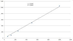

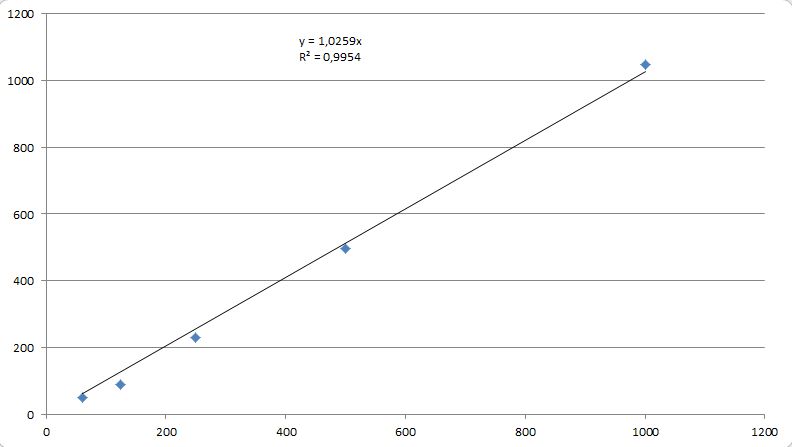

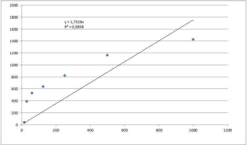

Also, I found a method including a microphone and Audacity but only for slow speeds. The results were really disappointing, huge variations. I even made the same for my OM10 to compare any error. OM10 showed small variations, acceptable considering the accuracy of the sound metering. But OM2 was way beyond this errors, making me think there is actually something.
Here are the graphs I made with the values I got on the x-axis and the ideal on the y-axis. The values are in ms. The first one is the OM2 and the second is the OM10.
As you can see, the OM2 does not only shows serious error in value, but also high inconsistency (for the 1s I got from 1.1s to 2.7s).
Before I can be completely sure, I first have to see the exposed film and see if there is anything useful in there.

UPDATE:
Today I got the test film developed. As I feared, the camera has serious shutter issue.
The CRT test showed that all high speeds (1/125, 1/250, 1/500, 1/1000) are actually 1/60 or maybe less.
The gray card frames come to confirm that. Equally exposed frames show serious deviation of density.
Also, I found two new SR44 batteries I had for my OM10. Hoping that the batteries could be the problem, I inserted them on the OM2. Unfortunately nothing happened. The shutter is still way off.
