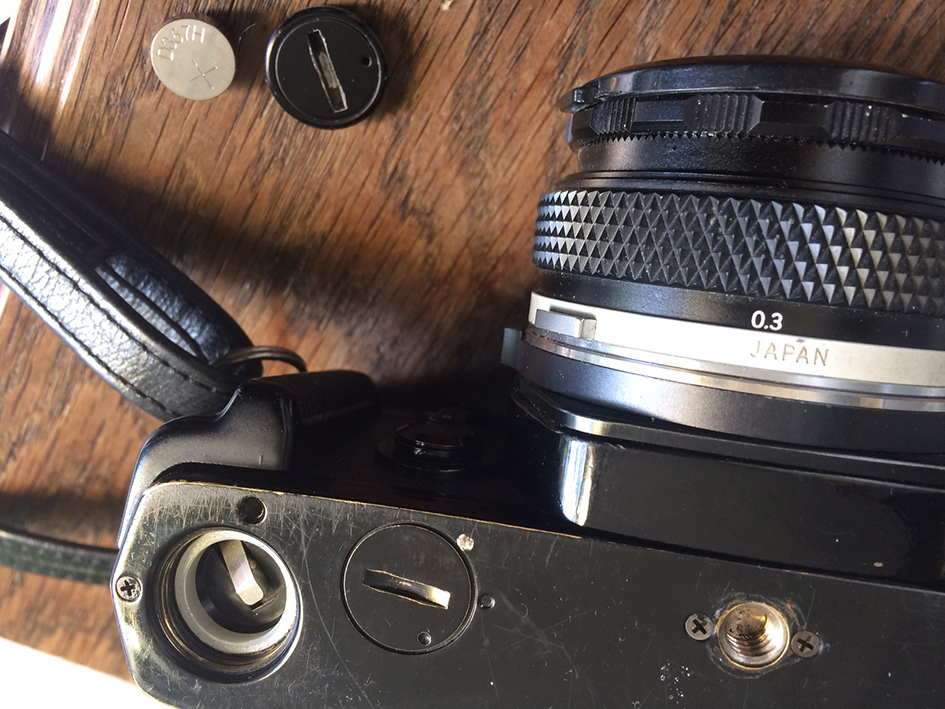

A picture of my OM-1. Is that ring inside the compartment your diode? Btw, how do you check that you are over-exposing?
I don't use any ring. The silver-oxide battery is smaller than the original one, but it still makes contact.
