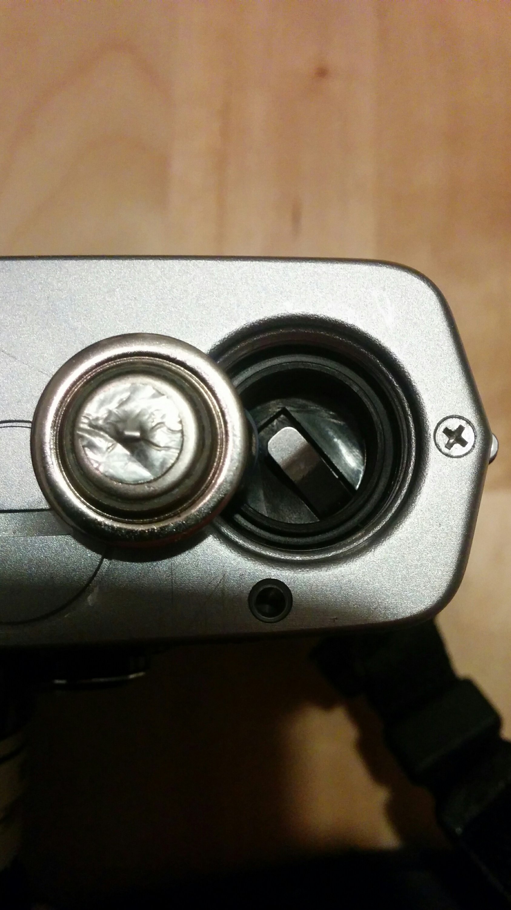

I just dusted off my om 1n to start using it again. I went to replace the battery as the meter wasn't working and ordered a d357h/sr44 battery (silver oxide 1.5v) the same as what was in the camera.
I then read about the original mercury batteries being 1.35v so bought a Wein cell mrb 625 as well.
It turns out that the Wein cell doesn't fit (diameter is too big) but the d357h is a perfect fit. I looks like I could take the washer thing off the Wein cell and it would fit.
So... My question is, do you think my camera has been adapted to fit newer d357h batteries? Im guessing It has and the voltage has been adjusted with diode. Or is it normal to use the Wein cell without the washer?
I've included an image of Wein cell that won't sit inside what looks like a plastic holder for the battery.
Thanks for your knowledge!
Tom

Welcome to APUG.
That looks to me like a collar has been inserted into the battery compartment. So the camera may have been adapted for use with the SR44 battery. I say "may" because there is no way to tell if the necessary circuit change has also been done.
Some times an adapted camera will have a sticker inside the film compartment confirming the adaptation.
The problem with using silver oxide cells in an un-adapted OM-1 is that the error arising from the voltage difference isn't linear.
In my case, I've got other meters that I could check the in camera meter against. I'd look around for someone who could do the same for you.
There are a lot of UK APUG people. Where roughly in the UK are you - you might be able to arrange a meet?

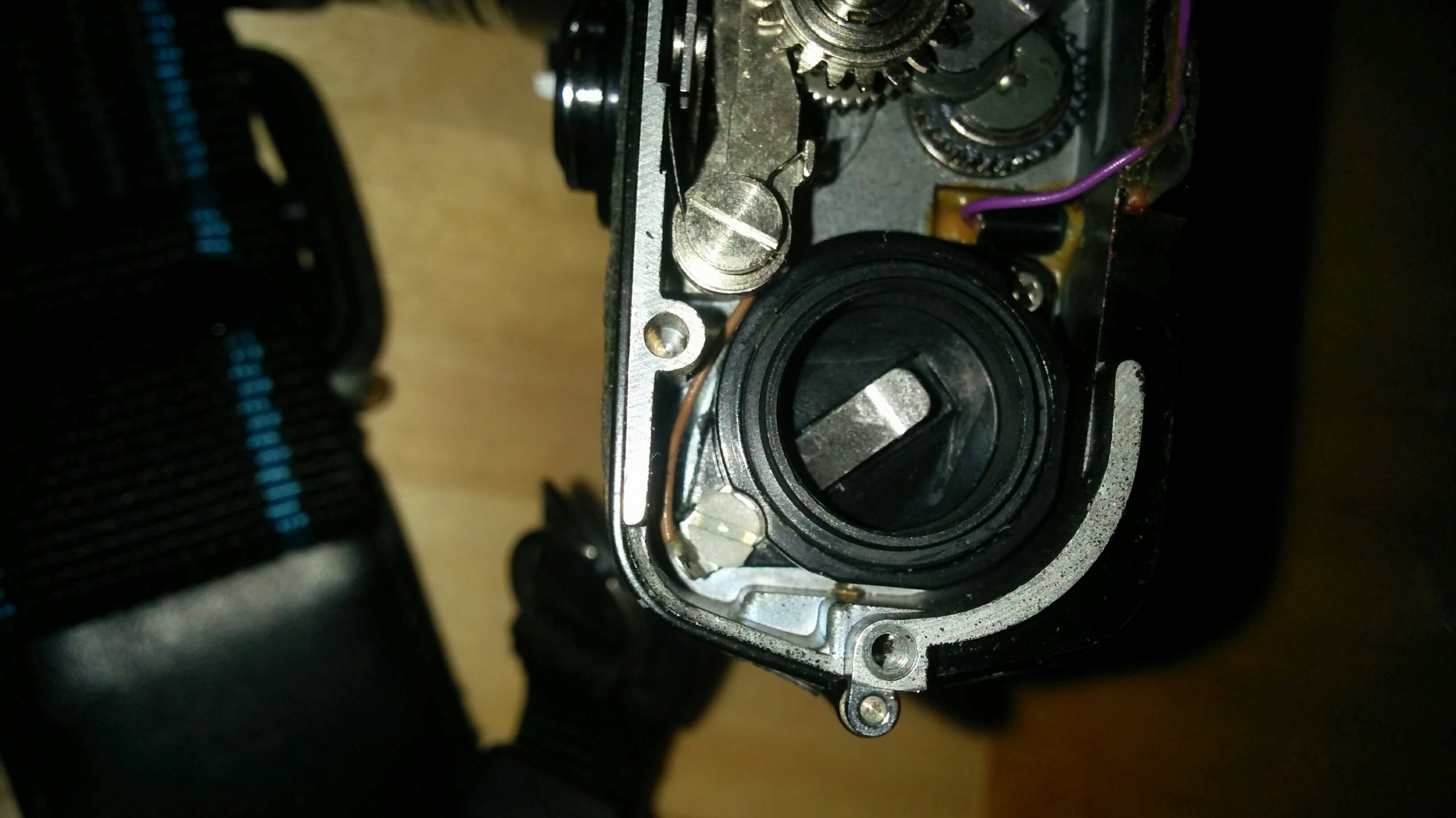

Might be worth taking the bottom cover off to have a look to see if one has been fitted? Only a few screws. YouTube video here on doing the diode mod

Good idea Ap, thanks for posting that video. I've had a look inside and there doesn't appear to be a diode. If it's got a separate sleeve inserted its a very good fit!
So is it best to use the Wein cell without the washer?

Unless the diode was fitted on the top and I have been told some would have done so, you are best served with a zinc-air ZA675 that you can get in packs of 5 at Boots.
The ZA675 is exactly the same size as a SR44 but its voltage is 1,4V. And that would be a perfect fit for that chamber.

FWIW, and that's not much.that's a slick battery compartment and it looks factory made. I'd
suspect if someone had that/those made the camera's been modified.......Oh well.

So I tried the wein cell without the washer ring, it fits perfectly but not powering the meter. I then used the 1.5v silver oxide battery and it is operating as usual. Although don't know if it's accurate!
I guess it has been given a diode somewhere, so I'll try shooting a film at normal metering and see what happens. And try to get hold of a light meter.
Both the silver and mercury cells have an essentially constant voltage over their life. The problem with using a silver cell in an unmodified camera is that the voltage is just plain wrong and the meter reading will be inaccurate, but the error will be consistent. Alkaline cells produce varying voltage over their life and need a bridge circuit to compensate for that. Neither the diode fix nor the MR9 adapter are a bridge circuit; they just add resistance to the circuit to drop the ~1.5V of the silver cell to match the ~1.35V of the mercury cell.
Given that the cell compartment has been modified with a spacer, the circuit has most likely been modified. But I have various cameras that were modified with no physical indication. It becomes a real pain to have a mix of "updated" vs not, especially since the MR9 adapter is the perfect solution, providing both the correct voltage and the correct physical size. There are two ways to know for sure; run a roll of slide film thru it and see if it comes back properly exposed or compare it to a known meter.
