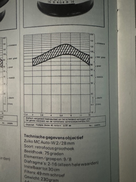

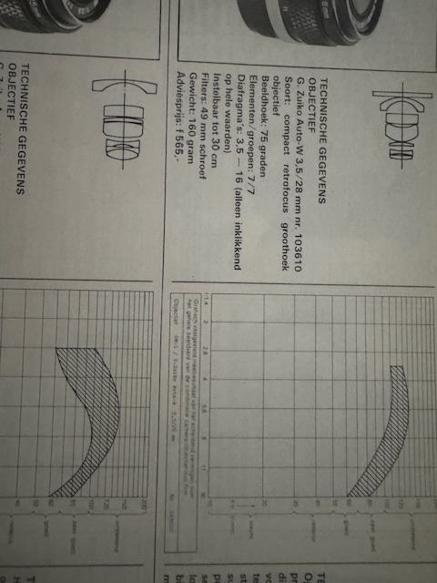

This is what testreports said when those lenses first came out.
i would choose the cheaper one.
