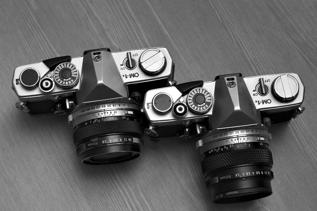

http://www.flickr.com/photos/11336821@N00/5349100247/
http://www.flickr.com/photos/11336821@N00/7011397917/

Many things to consider, but i'm wondering..
does anyone have a size comparison between the zuiko and nikon lenses? I'm interested in a wide variety so whichever ones you got will do. I can probably fill in the rest. I'm in particularly interested in the two 28mm f2.0's. This focal length I care about the most.
