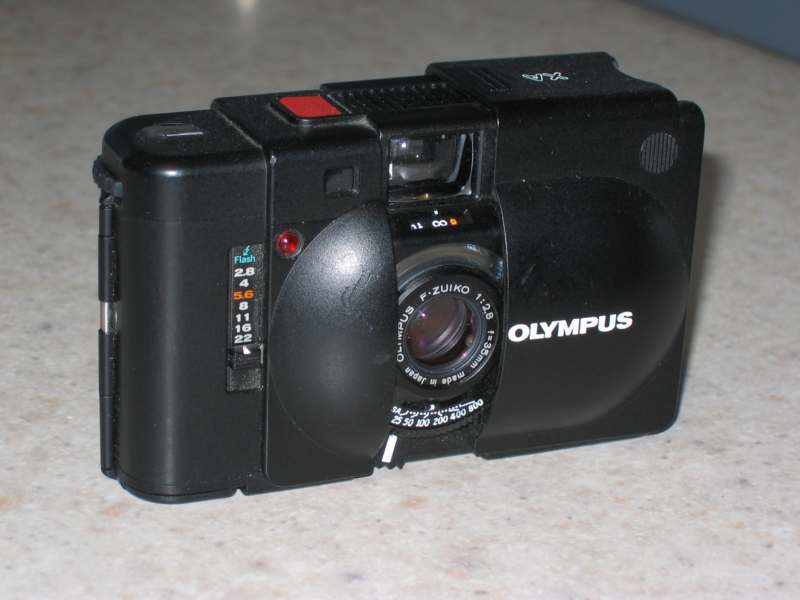

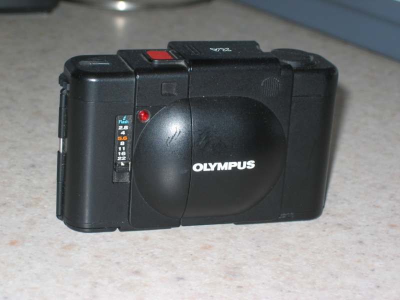

Hope you meant pics of the XA itself. If you can think of anything to fix this, I owe you a beer, heck, a case. I really like this little camera.
